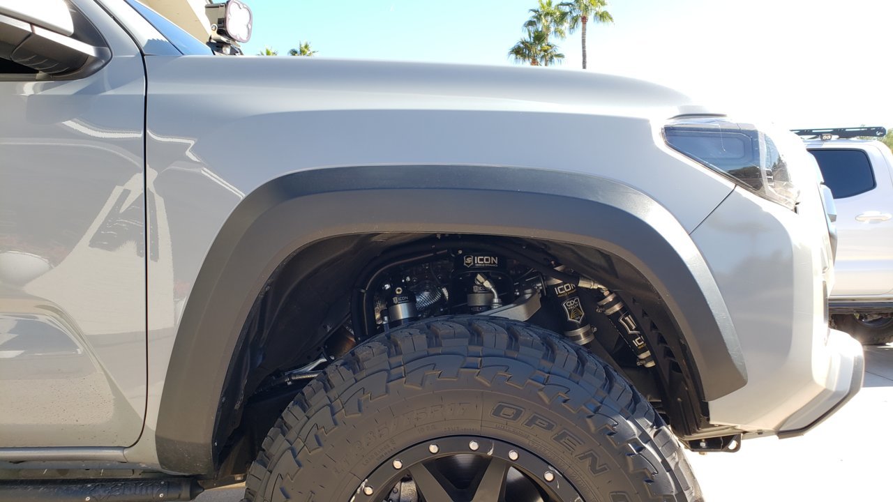

    I'm in a 3rd gen with full ICON setup if you want to check it out. I'm out of town at the moment but I'll be back on April 3rd.

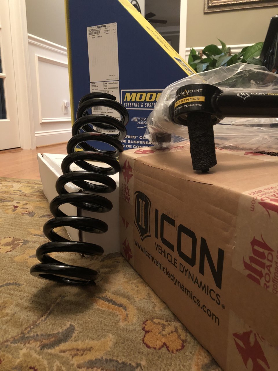

    I purchased 14” 650lb eibach made springs from wheelers off road, and swapped them out for the 13” springs that come with Icon. Less preload, love the ride. Its like a european touring sedan on road. Off road its supported pillow softness. :thumbsup:

    This also makes little sense. Going to a longer spring in equal rate will not “lesson preload.” It’s will actually stay the same assuming both springs are still good.
    The only way to lesson preload is to go up in spring rate or reduce the weight of the vehicle. Going up in spring rate will offer more lift but depending on other variables will ride more harsh.

    Kept the same spring rate; and yes- the ride is much better. Moved the adjustable collar up to keep exact same ride height AND lessen pre-load.

    You don’t understand the definition of preload.
    The ride quality difference you feel is called the placeabo effect. Many studies have been done to prove it.

    Yeah- you guys are right....:rolleyes:
    No need to overthink it. The 1" longer spring rides differently.
    Much rather have 14” spring, than a 13” spring that is compressed to equal the same height. The ride and behavior IS different.
