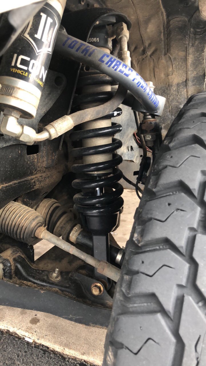

    I recently purchased my 2011 TRD Sport 4X4 w/ the suspension already done: Icons, w/ 700# Eibach springs, TC UCA's and an ARB Safari bumper (no winch). Out back, OME Dakars and Icon 2.0 resi's. 285/70/R17 Nitto Trail Grappler MT (load e)
    Here's what I've learned in the month I've owned it: The ride was pretty stiff, but most of it was due to the rear leaf springs. OME has the option of removing a leaf spring (third down from the top). I just removed that spring and the top overload spring. Additionally, I adjusted the c/o's to have 1 1/8 of preload (per Icon's install instructions for 700# springs). My truck rides great!
    I've read many posts suggesting a Deaver pack in lieu of the OME and they may be the solution, but for now, just a little labor on my part and the springs are much better.

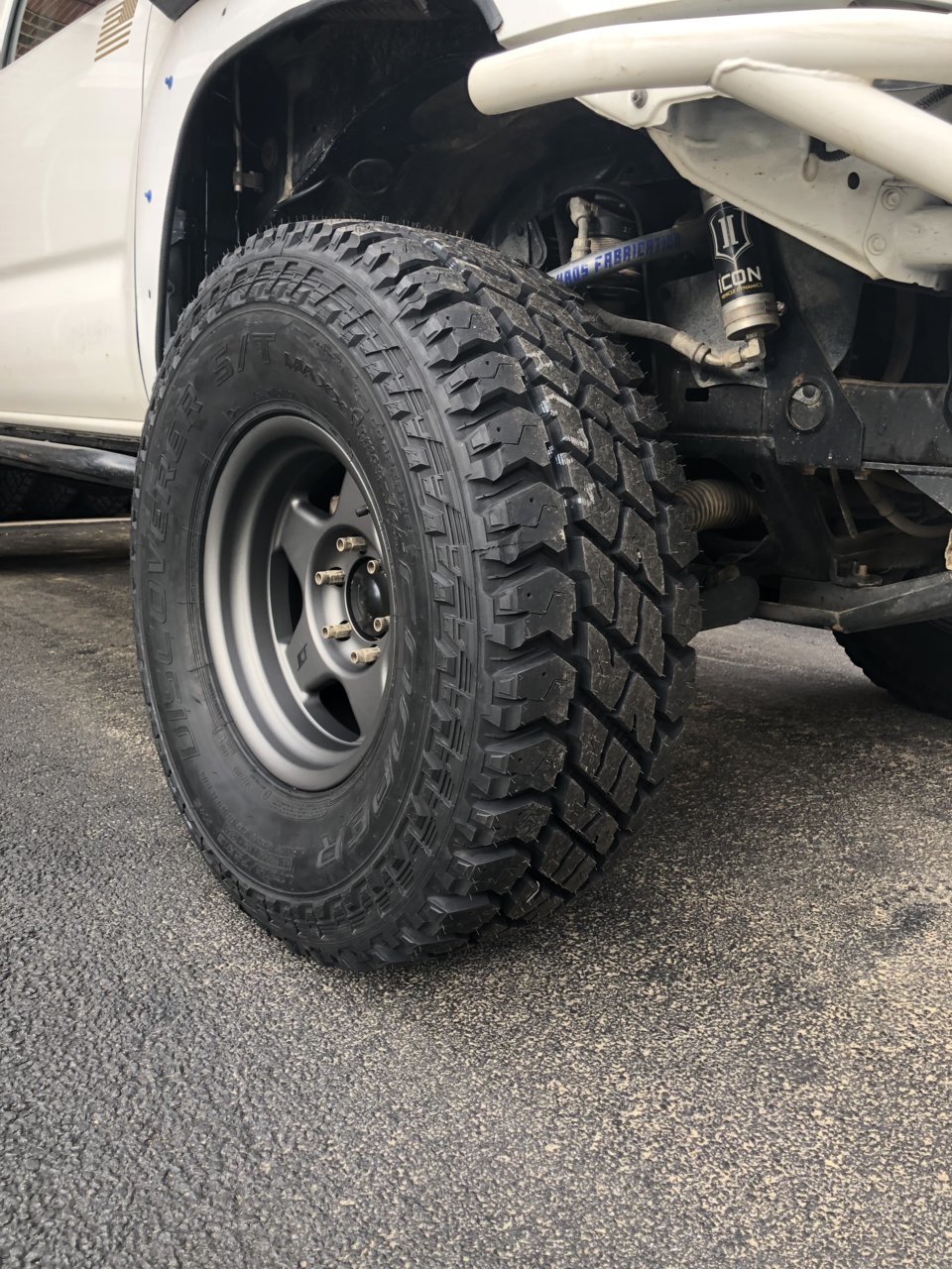

    Installed the 1/4” spacer on the driver side and dropped the preload to make up for the spacer. Was able to get 23” (center of wheel to fender) on both sides and 25” of droop (same measurement points). Rides much better now.

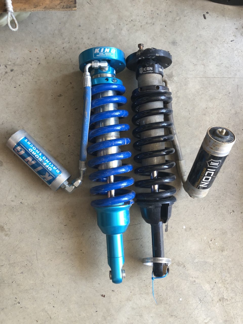

    if can, could use your advice on my LT setup: 6 months ago I switched out my Kings to Fox’s and even had them pre valved by Accutune (I wanted a soft Cadillac ride on the ripples of potholed roads)... $6500 bucks and 6 months later: still drives like a brick; even went as far as swapping out my Toyo’s to BFG KO2’s @ a D load for that softer sidewall
    I’m running all 6 of them at 200 psi (Fox and Accutune recommended setting), and on my coil overs I’ve got an inch of preload on 650 springs
    When off roading in the rough high speed stuff, there great.
    ...driving down my country road at 25 to 50 mph and I hit a pothole or just patch jobs: my cab shakes like I’m in an earthquake (have brand new cab mounts too).
    About every week, I’ll jump out, make some compression and rebound adjustments ... I’ll think I’m happy (cause that’s what we do)... but nope. Shakes and rattles like I’m in some old beater.
    As much as I love rambling off road and how cool our wide body prerunners look ,, there’s plenty of days I wish i just had my bone stock truck again ($30k later lol).
    grrrr
    re-valve ? Change springs ?
    any advice would be great, cause I’m so close to making her into a Park n Polish, and buy a stock truck lol
