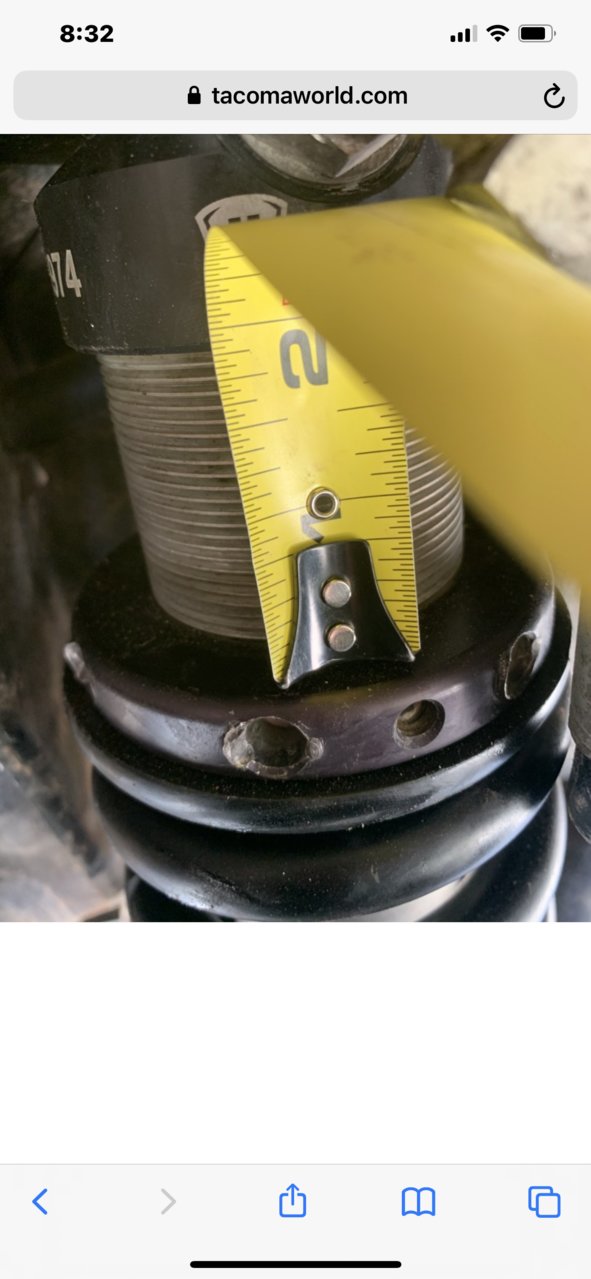

    So it looks like I’m good?
    crhsharks12 likes this.

    Thats too much for no added weight IMO. I ran mine (before steel bumper) and it was still a little stiff with the stock 650lb springs at that preload. I felt like less threads showing = smoother ride, until you get some real weight up there.
    Also don't ruin your expensive coilovers because you don't want to spend the $25 or whatever for the spanner. If you bugger up those holes you might be screwed....

    I haven’t ruined my holes yet. Also if you do ruin the holes, you can turn the thing still with some large channel lock pliers or something. Additionally, I have around the same as him and mine ride entirely fine with no weight up front

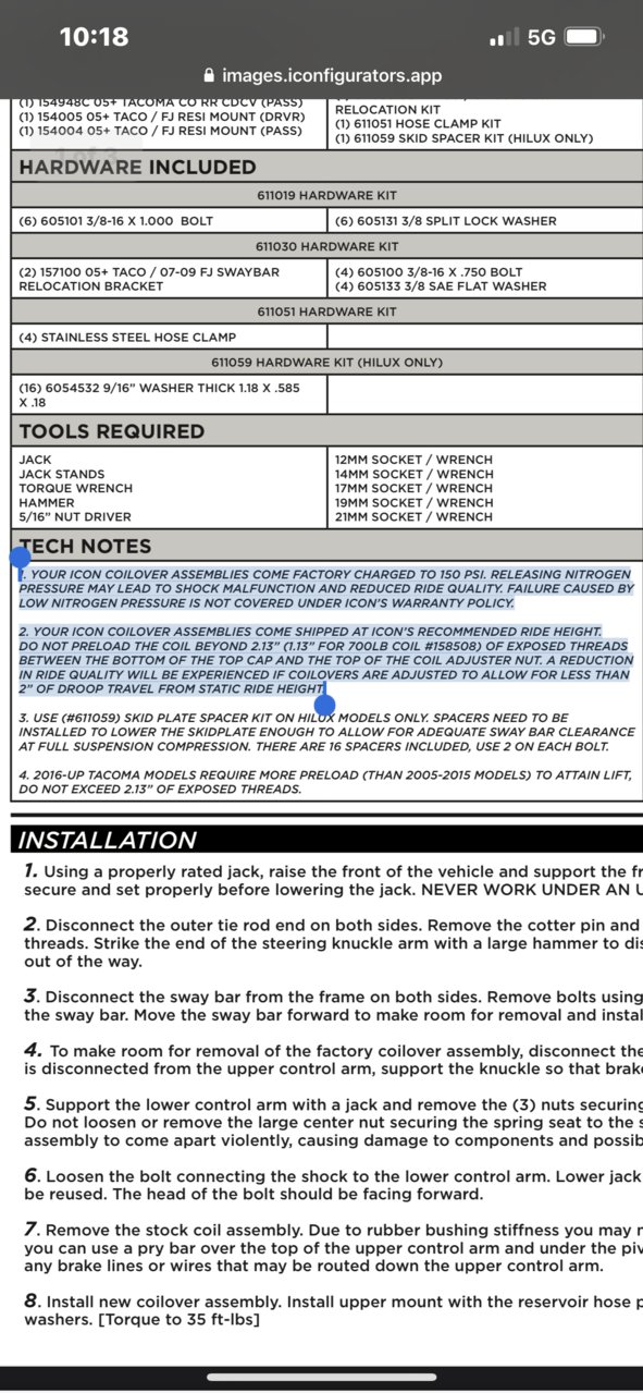

    So it says max at 2.13” but I’m more of like a 1.
    So it says 2.13” max and I’m more of 85%-90% of that... should I be more in the 50% of the 2.13% to get the best out of the coilovers? I’ve heard the spammer wrench from icon is terrible
