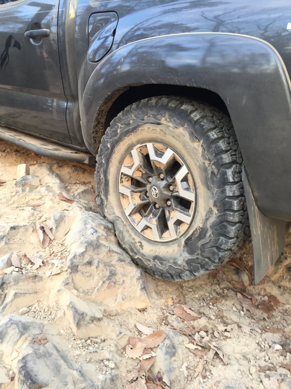

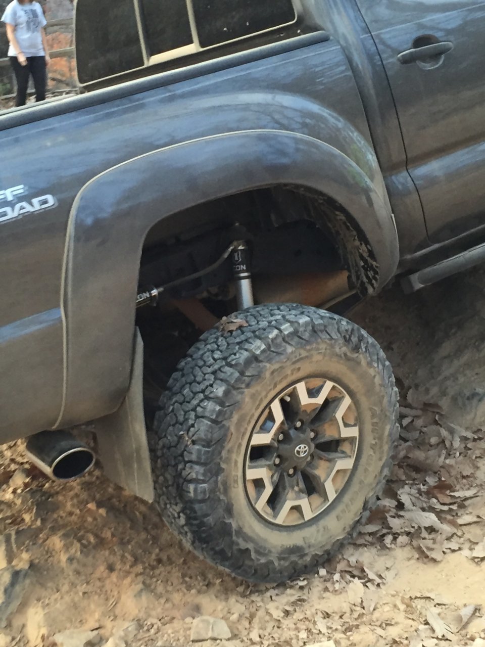

    Agreed. I have an SOS Off Road Concepts aluminum streamline front, planning to get my winch soon. I also have sliders, which adds weight to my truck.
    Also, as an FYI Old Man Emu "886" coils- their heaviest- are only 660lbs.
    Here is one example of what your current rear set up should be able to do:
    E69F5BBE-8E2D-4931-AF36-3D8DF2861FF5.jpg E734DDC8-25FF-4964-9903-9E8CB4C41496.jpg
