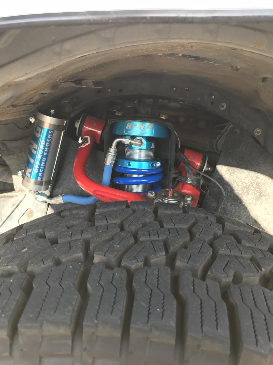

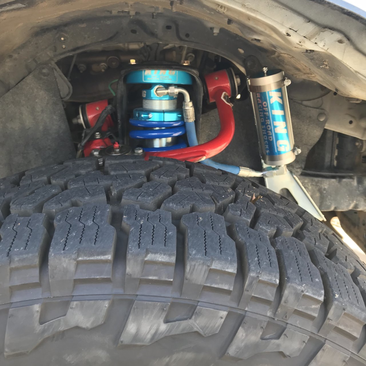

    Ended up going with kings. No adjusters, but it’s a big difference between these and icon. Kings are a lot softer and not so back breaking. I also noticed they didn’t need much adjusting to get a 3in lift as where my icons needed almost 2in of preload just to be at 2.5in.

    But that fucking blue!!! That's the sole reason I didn't do Kings is that damn blue.

    The blue is the best part! It stands out a lot and I really like it. Only thing I would change is my uca color
