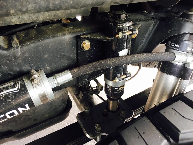

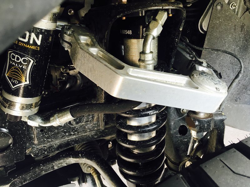

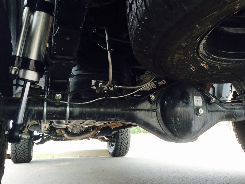

    CarsonTaco#16
    CarsonTaco#16 Well-Known Member
    Jul 21, 2016
    #192522
    80
    Alex
    Colorado Springs, Co
    2016 TRD Offroad
    Stage 7 Icon coilovers lift, toytec front diff drop, toytec/icon u-bolt flip kit, icon rear hydraulic bump stops, spidertrax wheel spacers, 285/70/17 Nitto Ridge Grapplers, Method NV Race Wheels, Morimoto Elite Hids, Morimoto Led fog lights, rocky road outfitters super sliders, Gobi stealth roof rack.
    image.jpg image.jpg image.jpg image.jpg image.jpg image.jpg Stage 7 Icon Kit with Hydraulic Bump Stops and Ubolt flip kit
