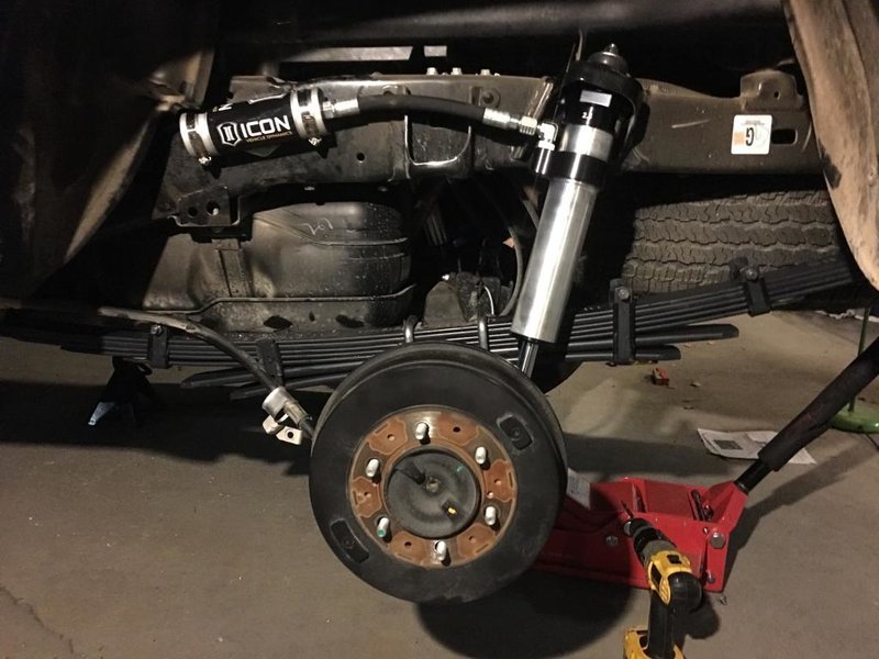

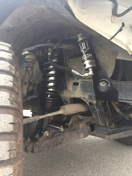

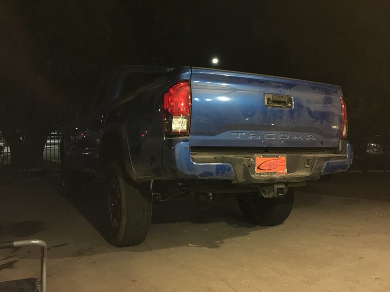

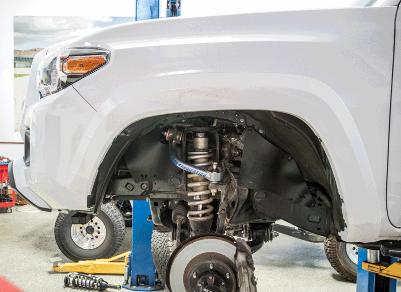

    Dropped my Fox Shocks and moved up to the Icon system with the CDVC. Very happy I did, I really enjoy this new setup. Thank you to @1MK for the pro Install and photos and to @tubbsisland for the Awesome price and swag!

    Nice photos!!!
    How does the ride feel different? How does the feeling change using CDVC?

    Noticeable difference all around just on the street, feels like I have some real shocks under me. I haven't been the dirt yet to fully test it out. The CDVC is great for when i gear the truck up for over-landing or when the bed is just empty for around town.

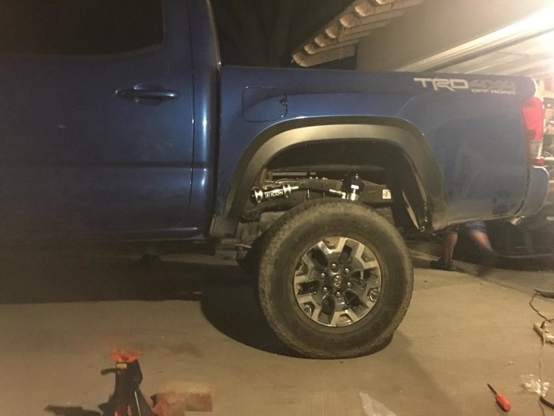

    These are all in my build thread but here are a few.
    I have the Stage III, although, in the sheet above it doesnt list the rear reservoir. I got rear rez's with mine.
    One thing to note, I had to get my alignment done 2x, about a week apart.

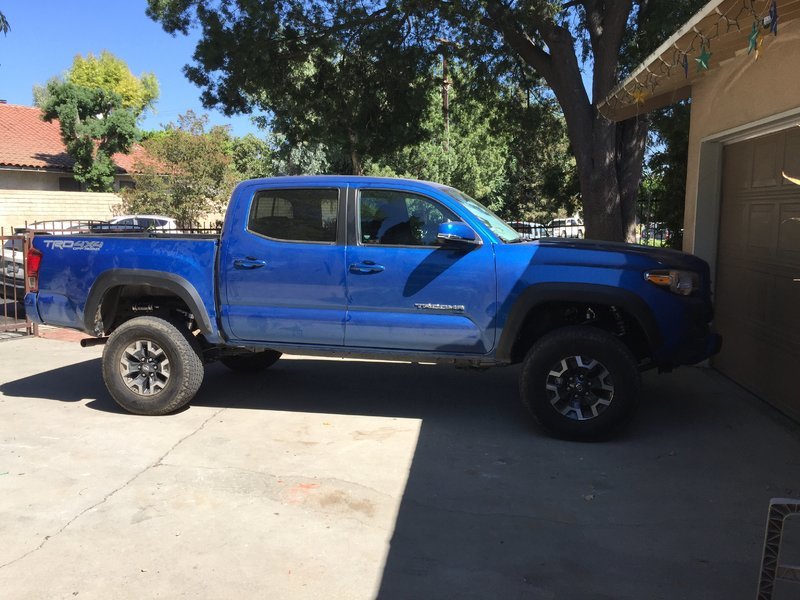

    Icon stage 3 with Total Chaos upper control arms. 17x8" FN FX Pro's with 275/70 BFG KO2's. PS coil is stock height, DS coil cranked 6 rounds to even out the lean.

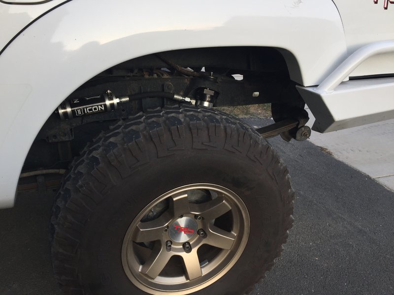

    Just finished my lift yesterday ! Stage 5 but used Dakar leaf springs instead of add-ons. Just need to lift the fronts to match the rears and wait for my Rims :) and I'll be set ! Loving it already !

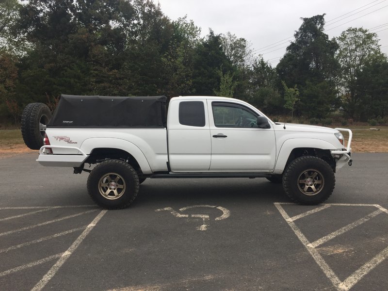

    Nice! That's exactly what I have, except with 700lb springs in the front, and standard travel. And no CDC. Ive just been waiting a few days for the springs to settle, and waiting for my winch to arrive, before I lift the front more.
