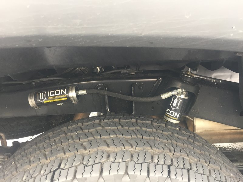

    Hey guys, I'm about to order a lift, I just wanted your thoughts real quick before I pull the trigger. So I have a steel bumper and winch going on which will add over 250lbs in the front. I'm running 265/75/16s on stock OR wheels. I would like as much lift as is reasonable and functional (not cranking down preload all the way). This is what I'm planning to order:
    Icon 2.5 with res and 700lb coils.
    Total chaos uni-ball UCAs
    Dakar leaf packs, removing overload, possibly even overload+middle
    Icon 2.0 standard travel with res
    My question is, with all the weight in the front, even with the 700lb springs I don't think I will get more than an inch and a half, maybe closer to an inch over stock.
    So am I correct in thinking theres no need for the extended travel rear shock? I am only trying to achieve no more than 2" in the rear, since I will get less than that in front. I like the factory rake, but I'm OK with adding another inch of rake. Not more than that preferably.
    With the standard travel, I won't need to change brake lines or install bump stops either which is nice.
    Thanks for any input, it is appreciated.

    Go with the 700lb springs you will get an inch and a half in the front with them set at about 3/8 of threads showing. I have the icon stage 3. I love it so far.

    I do not have a front bumper, not yet, and i have the extended travel in the front but in the back i assume they are the extended travel 0-3in, the leafs basically control the range of travel. Does icon specify if they are extended travel for the reasr? i just have the 2.0 with res they work great.

    Yes, there are both standard and extended travel rear shocks. Seems like most of the kits come with extended travel, but they don't include bump stops. Aside from bump stops, extended travel also require longer brake lines.
    Marie at Headstrong told me longer bump stops are pretty much required with the extended travels in the rear. Otherwise you risk damaging the shock because it is the limiting factor in up-travel without longer than factory bump stops.
    She gave me some numbers which I jotted down. The standard Icon 2.0 rear is 14.25" compressed and 24" out. The extended is 15.9" compressed and 26.5" out. With the extended you gain droop, but lose up-travel.
    For my purposes (heavy bumper and winch, don't want to preload very much) I will only gain maybe an inch in front over stock (2" on a gen 2). So since I don't want a ridiculous rake, I will be taking out the overload leaf and probably even the 3rd leaf from my dakar leaf packs which should put me around 2" in the rear.
    She definitely knows her stuff, very nice and smart girl. I learned more from talking to her for 30 mins than I have been able to spending hours and hours on this forum. I would look into the model number of your shocks and see. Did you do carrier bearing? How much lift did you get in the rear with the Icon AAL?
