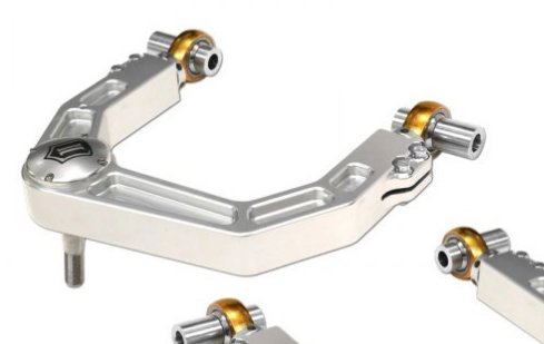

    How are the billet ones adjusted? I cannot find anything on this.

    I had to contact ICON directly to get this info but in this picture below you can see they have 2 gold eye bolts on each UCA that you can adjust in and out to adjust more camber and caster.

    Can that adjustment be made with them installed? Looks like you have to twist those to move them in and out. With the large pivot bolt holding them you would not be able to twist them unless you removed the bolt!

    Icons design is unique in that its a 3 piece setup. There is the arm itself, an adjuster sleeve and then the heim. On a conventional heimed UCA your UCA bolt would need to be removed entirely to make any adjustment, on the icon setup you adjust off the adjuster sleeve which does not require removing the UCA bolt.

    Thanks Cliff, Spoke with you on the phone last week for a kit for my 14 taco. Still trying to make up my mind between the stage 3 or 4 and which UCA's to go with. So to adjust these you loosen the two set bolts then twist the big nut next to the gold eye bolt? Tubular or Billet to many choices.

    exactly, its still kind of a PITA to adjust and you probably wont make any adjustments beyond your first alignment but it is still far easier than the other options out there without sacrificing any real strength.

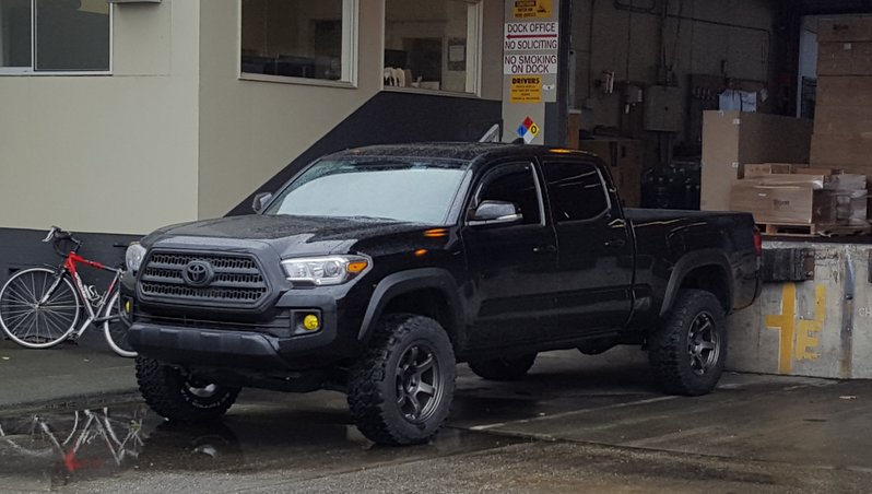

    Stage 3 ... 285/60s on 18x9 FN BFD rims ... I need a few more turns on the coil overs to even out the rake.

    @ToyotaLifer lift looking good. Wondering how much caster you were able to get post alignment? I got 2.3 caster on both sides. Hoping to get more on mine.

    Looks awesome
