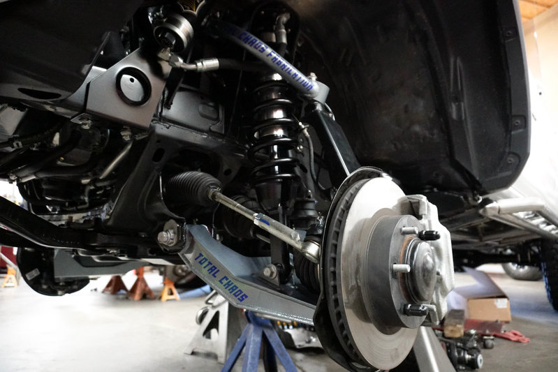

    Icon Stage 7 Front end. Swapped to TC Heimed UCAs and Race series lower arms.
