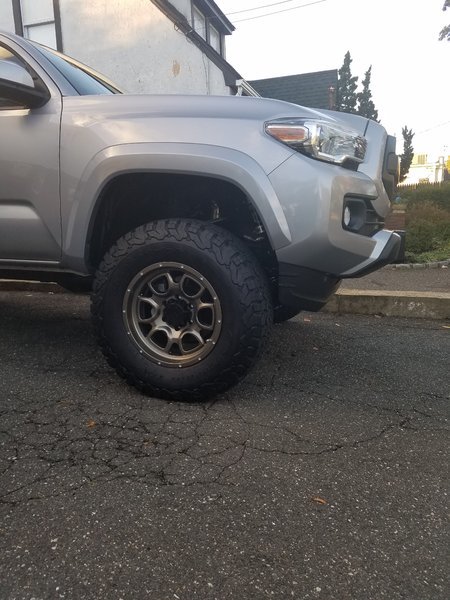

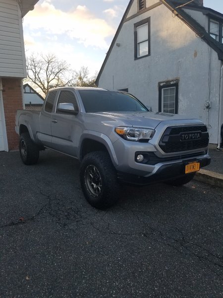

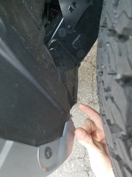

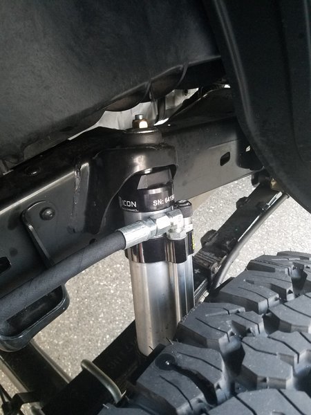

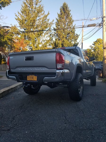

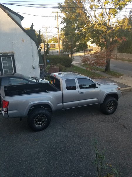

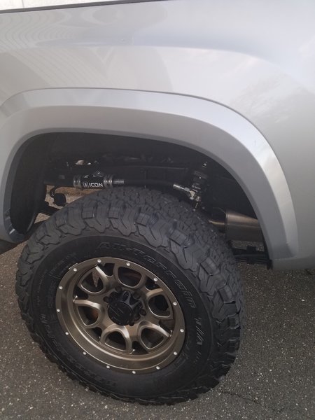

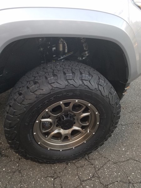

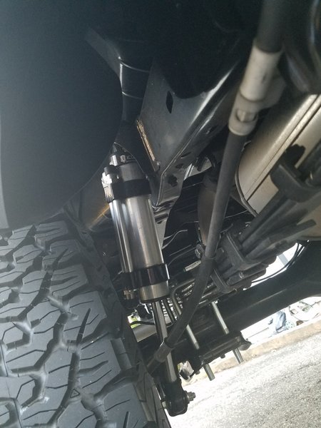

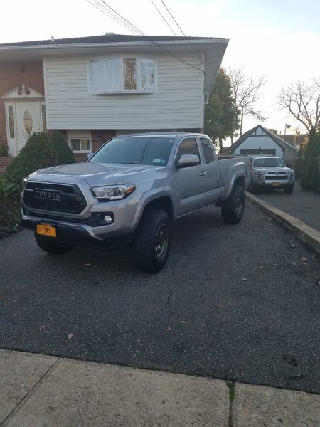

    Installed a Stage 7 kit on my truck last week. Overall completely satisfied with the kit. Only thing that bothered me had nothing to do with the install, but rather that the uniball covers and coilover adjustment tool was extra. For stage 7 money they should include that in the kit, just my honest opinion of course.
    In terms of the people on the fence about doing a lift kit or modding their new truck, its as simple as "are you in or are you out?". If the warranty issue is in your head and it making you nervous, by all means stay away. As an avid offered enthusiast (Trucks, ATVs, Dirtbikes) sometimes there is a necessity to cut, trim, and notch things in order to eliminate issues that arise. Granted if things are developed properly for an application it should be minimal at best, but sometimes you gotta make sacrifices for capability. Im a firm believer that if you take care of your stuff and do it right the first time, your stuff will take care of you. Again my own honest opinion.
    Some pics:

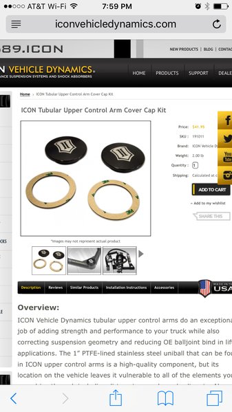

    Is everyone with the tubular UCAs buying the caps?

    2016 Tacoma SR5
    I bought them

    Dielawn1o1
    Dielawn1o1 Well-Known Member
    Jun 16, 2016
    #189763
    103
    Dylan
    '16 Tacoma TRD OR Orange
    yea I got them too might as well protect your investment

  11. Nov 5, 2016 at 8:43 PM
    #451
    Filthy13
    Filthy13 Well-Known Member
    Sep 27, 2016
    #198402
    123
    2016 DCSB 4x4
    I'll probably get them as well. Did you apply triflow before covering?

    I bought them.

    I did, I also waited until after my alignment to install them just in case I had to remove/adjust something.
