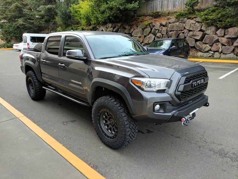

    I've got stage 6 installed, and I didn't get a tremendous amount of lift out of the front. I had to max out the driver side just to get it level with the factory setting on the passenger side. May be due to my bumper winch. Anyone have any recommendations? Should I bite the bullet and go with the 700 lb spring?
    I wouldn't be completely concerned except that I have a good amount more rubbing than I was expecting on my new tire/wheel setup.
    Setup is stage 6, 285/70r17 duratracs, SCS ray10. Additional weight in the front is ~130lb from bumper/winch and maybe +15lb from new battery on driver side.
    Fender to hub measurements are ~23.25" in rear, ~22" in front (driver coilovers are maxed out at ~2", passenger untouched).

    285/70r17 will likely need a body mount chop to fully eliminate rub.

    Yeah I got the chop even before putting the tires on. Really rubs on the metal fender behind the plastic liner. Found some folks locally to cut/hammer/weld so hopefully everything is smooth sailing shortly :)

    What hidden winch set up you using?

    Southern style off-road slimline bumper. It's actually a steel bumper that just replaces the plastic chin, very sleek and low profile. You can also get with bull bar and light bars if you want that instead.

    I think you mean the pinchweld.. We had to pound those back on the 1st gen taco's (for tire clearance).. As soon as I get my lift on, I will know more about the 3rd gens:)

    I do believe you're right. I found some folks who are familiar with running 35s, and we sorted everything out. It was all the fender metal behind the fender lining between the cab mount and the flair. Took about an hour to cut, bend and paint. Happy to take pics!
