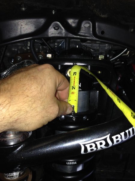

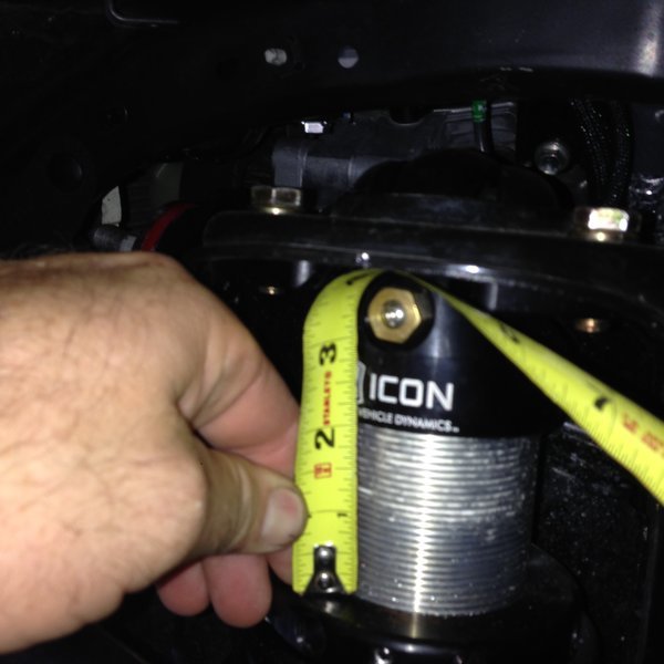

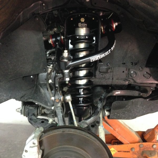

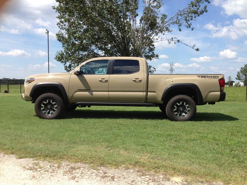

    I just got back from the alignment shop. I did Icon 2.5 extended travel coilovers in front Built Right Uca's and Icon progressive 3 leaf pack in rear with overload left in and the icon 2.0 shocks. I ended up getting 2" all the way around. That is what I was looking for as I wanted to keep the factory rake.
    I had to set the driver side at a hair over 2"of threadshowing and passenger at 1 5/8" of thread showing. Iwas hoping to not have tocrank them that much but...Anyway I guess you could go higher but you would be going over what icon suggests. The ride like everyone says is stiffer but takes the bumps and holes great! I am running 265/75/16 Toyo at2's and have no plans on going bigger. Truck is a DCLB OR 4x4.
    Center of hub to fender is
    Df22 1/2"
    Pf22 5/8"
    Dr23 1/4" full tank of gas
    Pr24"
