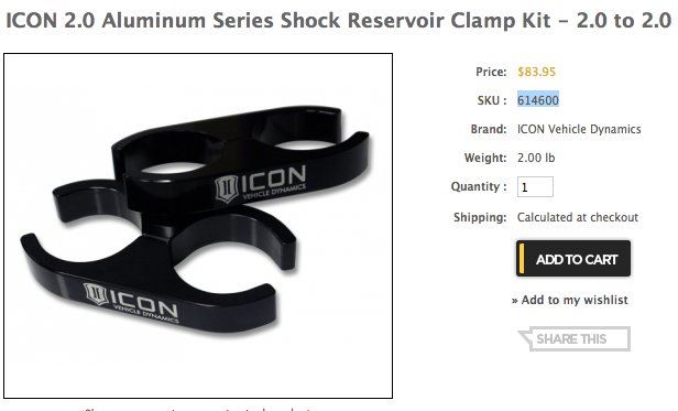

    have any of you guys on here used the reservoir clamps instead of drilling into the frame to mount the bracket? i would prefer not to drill un-needed holes in my frame.

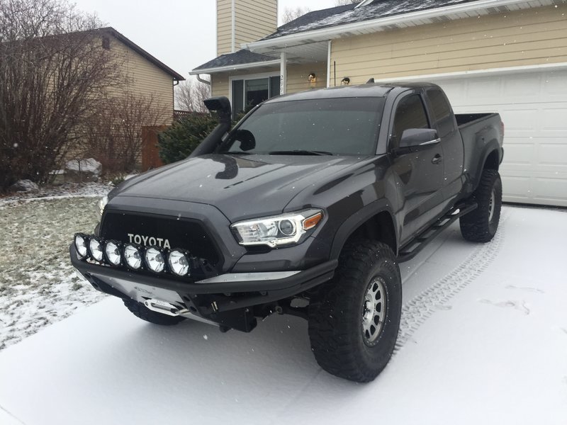

    #180700
    51
    What bumper are you running? Looks great!
    Edit: nevermind

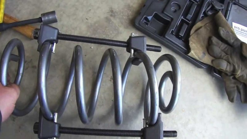

    Has anyone taken their 3rd gen to Icon themselves in order to have them adjust the coilovers to the perfect/recommended height?
    As far as adjusting them with a spanner wrench, I've been hearing that the best way to adjust the height is to remove the coilover and use a spring compressor. This is to prevent messing up the threads and scratching the finish on the coilover.

    I am not a 3rd gen but have the icon stage 5 on my 2014. I just jack it up with the wheel off the ground. Clean what dirt you have on the coil over with a tooth brush. Spray wd40 on it and adjust it. Works fine for me.

    Did you use a spanner wrench?

    Yes the Icon one. worked great.
