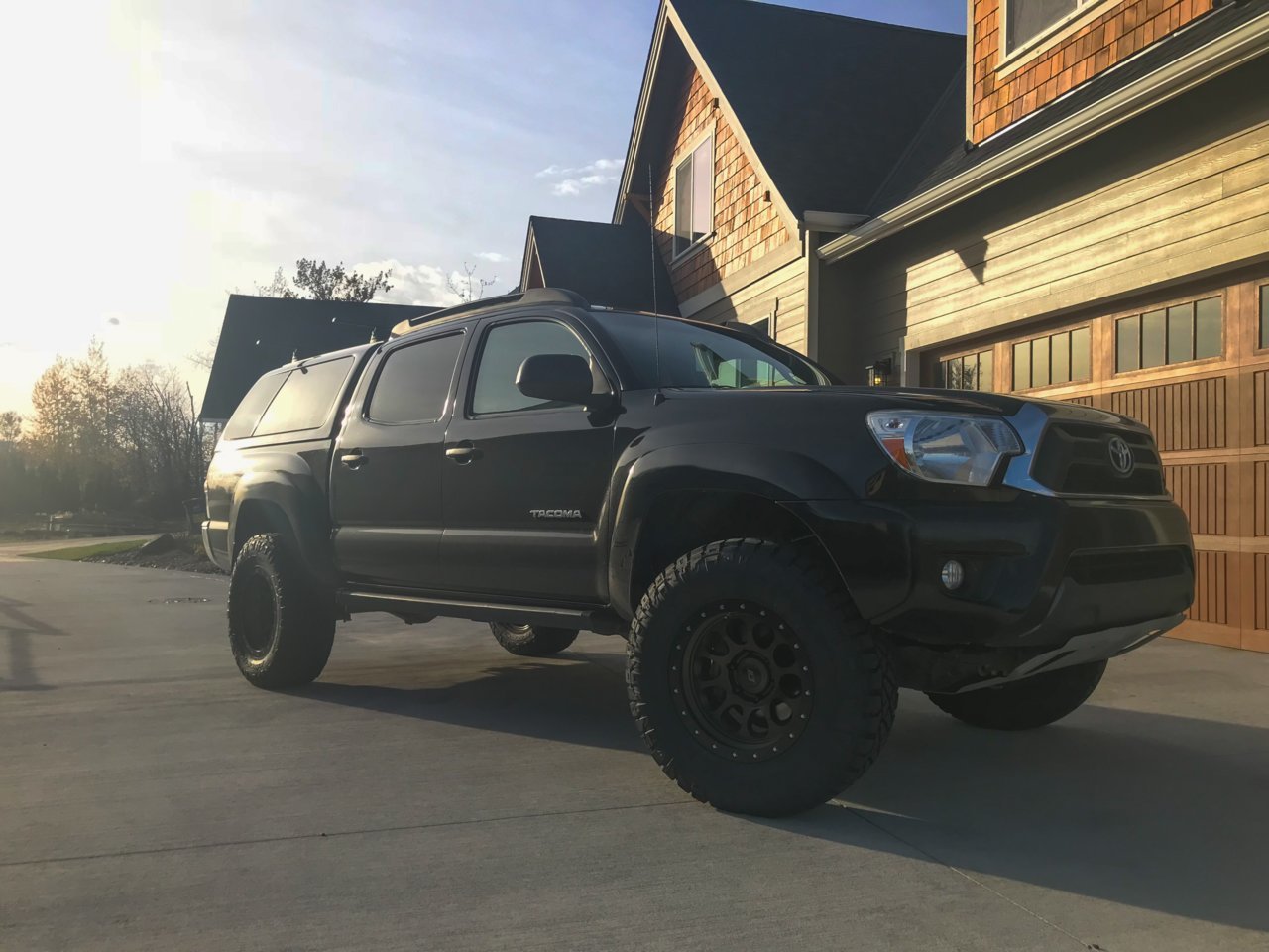

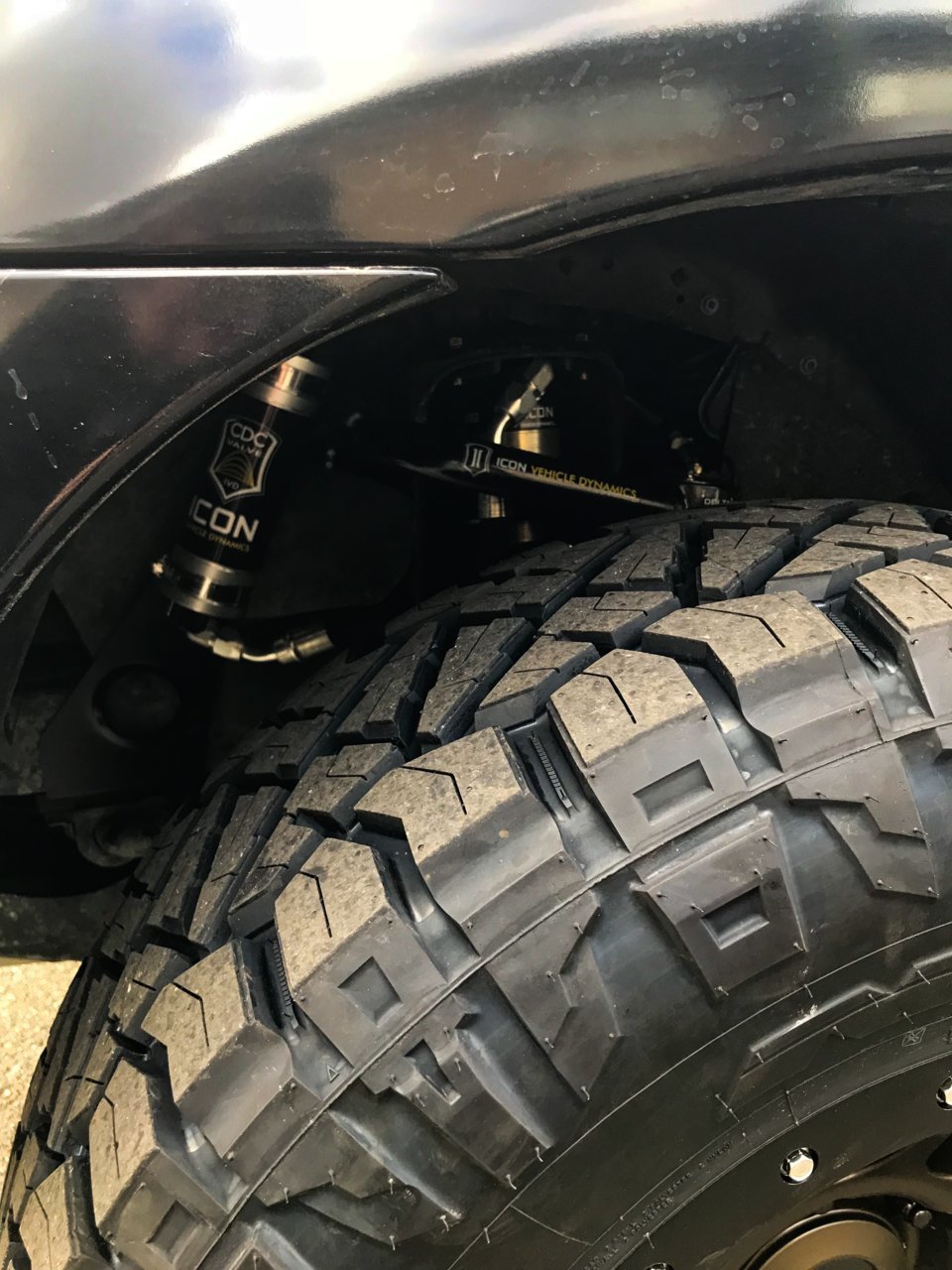

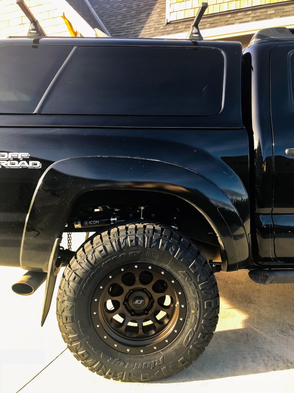

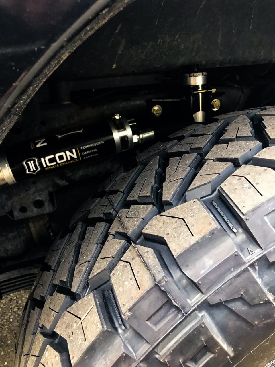

    Here goes my first foray into TW: just got Icon stage 9 with hydraulic bump stops installed the other day, paired with SCS Ray 10s, and Nitto Ridge Grapplers. this isn't going to be healthy for my wallet... also looks like the shop put the fronts on out of the box, anyone have any recommendations on setting the preload, or should i leave it, as is?

    #271584
    2
    How did it change the ride quality over stock on highway regular paved roads. Did you notice it improved?

    2k4Taco

    I'm pretty sure Icons come pre set, you could adjust the preload depending on the ride quality and height you want.. looks good to me though. Any rubbing?

    It was rubbing pretty bad when they put it down the first time, so it has a pretty aggressive CMC. They said that was what they have had to do every time the put SCS wheels on because of the off-set. i want to run 35s one day so I also had them get it ready for that when they day comes.

    I'd your happy with the ride quality I wouldn't adjust the preload, maybe the adjust the cdc?

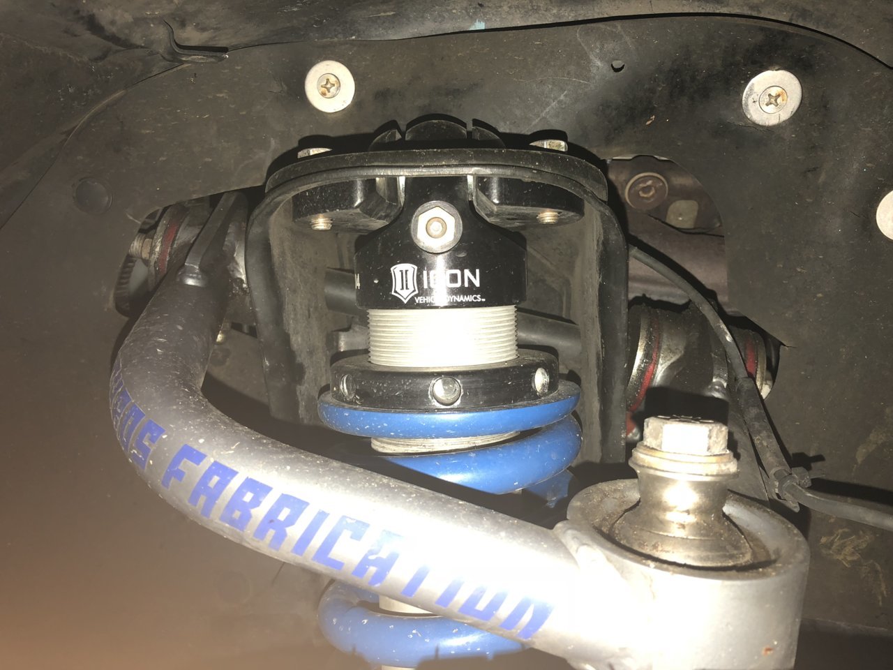

    What is your ride height, center cap to fender, measurement? Good looking truck btw!!

    Hey, here’s the best I can find pics wise... but with a 700lb 14” spring you do not want to exceed 1” of “preload.”
    I’m sitting at 2.5” with just under an inch of thread showing.

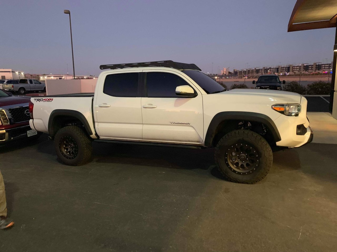

    Stage 10 setup just installed on monday. Sorry for the dark pictures as I have still yet to see the truck in daylight thanks to work!.

    New ride 2024 TRD OR. Old ride 2014 Icon Stage 5, 265/75/16 BFG AT KO2, Fuel wheels, KMFB sliders,BAMF trilogy skids, Baja Design Squadron Sport WC
    Took the truck into Mikes Custom Toys to have some work done. Wow, I drove in thinking my truck was in good shape. I left there thinking i was in a new truck. Great guy to work with. Great shop and AMAZING work. Had my Icon 2.5 reservoir shocks all rebuilt. New 700lb springs added, rebuilt my UCA with the delta joints and replaced my Icon AAL with the Dakar leaf spring ELO95. My wife noticed the ride difference right alway. So much smoother. I will for sure go back when i need more work.
