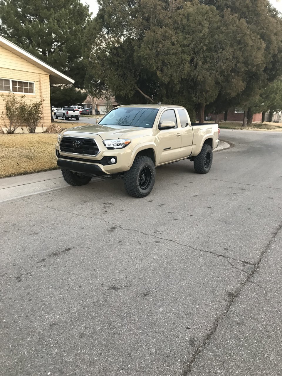

  20. Jan 12, 2019 at 4:59 PM
    #800
    Chopper dog 1962
    Chopper dog 1962 Member
    Sep 8, 2018
    #265619
    12
    Scott
    Carlsbad new mexco
    2018 quicksand AC 4x4
    Icon lift wheeles 285/70/17 Firestone mt tires
    Ok got some pics
