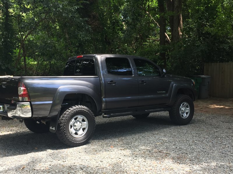

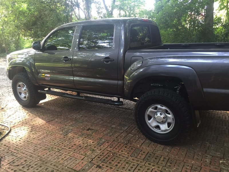

    Hey guys... so I bought an Icon stage 3 suspension kit, subbed out the add-a-leaf for a full Dakar spring set. Since installation I have been battling some vibes. Wanted to get your expert opinions. Love this forum and how much knowledge and help there is!
    1. Small take-off vibe. This isn't a big concern to me. I can deal with it.
    2. Feel vibrations in the steering wheel + in the gas pedal around 65mph.
    - This one is a little more annoying.. here are the steps I've taken to try to remedy
    a. Installed OME driveshaft spacer kit (FK29)... no real help
    b. leveled the truck... there was some serious rake due to the dakars providing much more lift than the icons set at the standard 2.5"... no real help there.

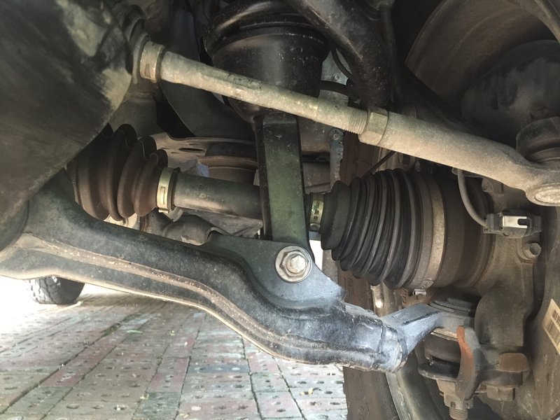

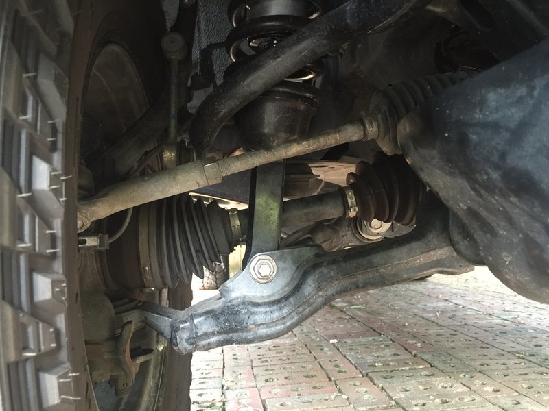

    c. Installed front differential spacer kit. No real help, PLUS I feel like I get a "whirling" rotational sound when hitting around 50mph. Almost like a warped rotor or something but not quite AS drastic. I provided some pictures below of what the boots look like post-spacer install. Does this look ok? I am thinking of taking the spacers back off.
    d. I also ordered some 2 degree shims for my rear axle to try to collect the angle of the yoke/driveshaft. A tech at 4wheel parts told me I was off a little under 3 degrees.
    I have to say, I am pretty frustrated with the overall situation. Thoughts on the steps I have taken? Anyone else run into these issues with a similar setup? I thought that buying from a reputable company and spending a good amount that I would avoid some of these "engineering issues." @icon_rep any thoughts? have you guys had customers run into similar problems?

    I think your on the right track with your shims, but do post some pics of your drive shaft to get a baseline of where your at. The diff drop I would not recommend, as few do, it looks as if your angles are more extreme up front due to that, cv joints. You might want to consider removing that. Did you install a sway bar relo bracket?

    I would also be recommend getting a "road force" balance of your tires to rule out any wheel balance of out of round tire issues.
