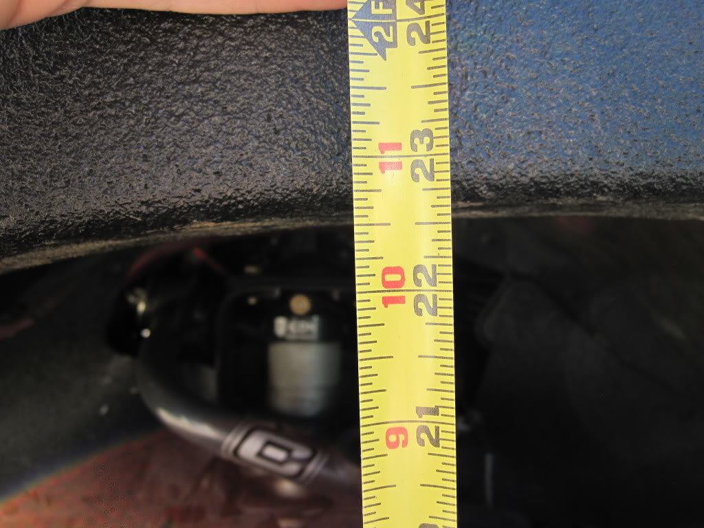

    I'm running the Icon extended travel coilovers with a heavy winch and AllPro plate steel bumper. But I'm using Camburg UCAs. So, I can't comment on if the LT UCAs will be a problem or not, but I am considering upgrading to a different coil spring -- maybe a King 14" long 700lb/inch spring. See this thread: http://www.tacomaworld.com/forum/suspension/212046-icon-2-5-c-os-king-14x700-springs.html
    This guy has already replaced his Icon coil spring with the King one mentioned and he will likely be installing his aftermarket plate steel bumper and winch this weekend . . . can get his opinions on ride quality.
    My coils are cranked to here:
  17. Apr 6, 2012 at 5:55 PM

    With this level of preload on the Icons, my lift is as seen here, measured from the center of the wheel to the fender:
