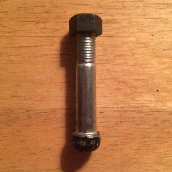

    Anyone have instructions for installing the ICON progressive AAL and keeping the overload in?
    The aal is painted over the pin and looks like it would have to be tapped out in order for it to be re-installed through the OL up through the AAL and the rest of the pack,
    Can anyone validate this?

    On my 14 access cab sport pre runner the factory pin isn't threaded through the original leaf pack. Once you remove the factory pin you should be able to remove the pin On the icon and place the 3leaf in the leaf pack and re install the icon pin. I just installed my AAL Tuesday but took out the OL. Here's a picture of the factory pin that I removed from my original pack. image.jpg

    ^^ cool, thanks bud.
