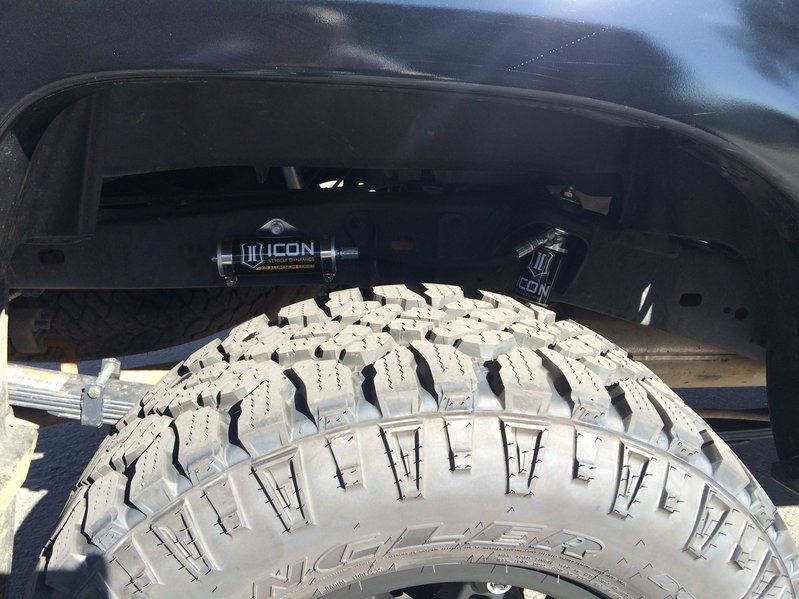

    Icon extended travel coilovers in front, Dakar leaf pack in rear with icon 2.0 resi's
    image.jpg I have the icons with dakars too. As pretty much everyone said, it is a great setup. I would highly recommend it. The ride is a little harsh with nothing in the bed, but I put my dirtbike in there and it settles it right down.

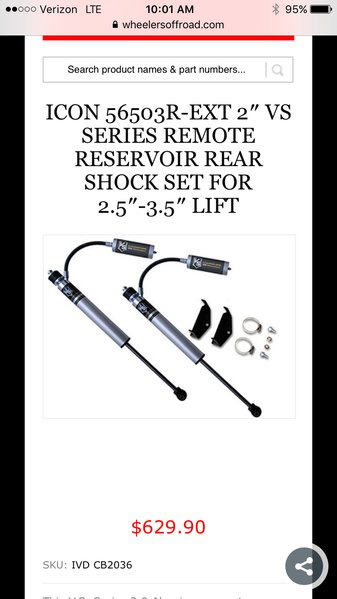

    Wheelers sold me a shock made for use with aftermarket leaf packs that lift the rear over 2.5 inches. I'll try to get details for you.

    So according to Scott those shocks are only rated for 1.5" of lift. He said they will probably work, but you won't get as much downtravel as you should.

    YOU NEED TO MEASURE YOUR COLLAPSED LENGTH.
    running a shock meant for a 3+in lift might yield a collapsed lenght that is too long to the point of bottoming the shock before hitting bumpstop.... BAD!
