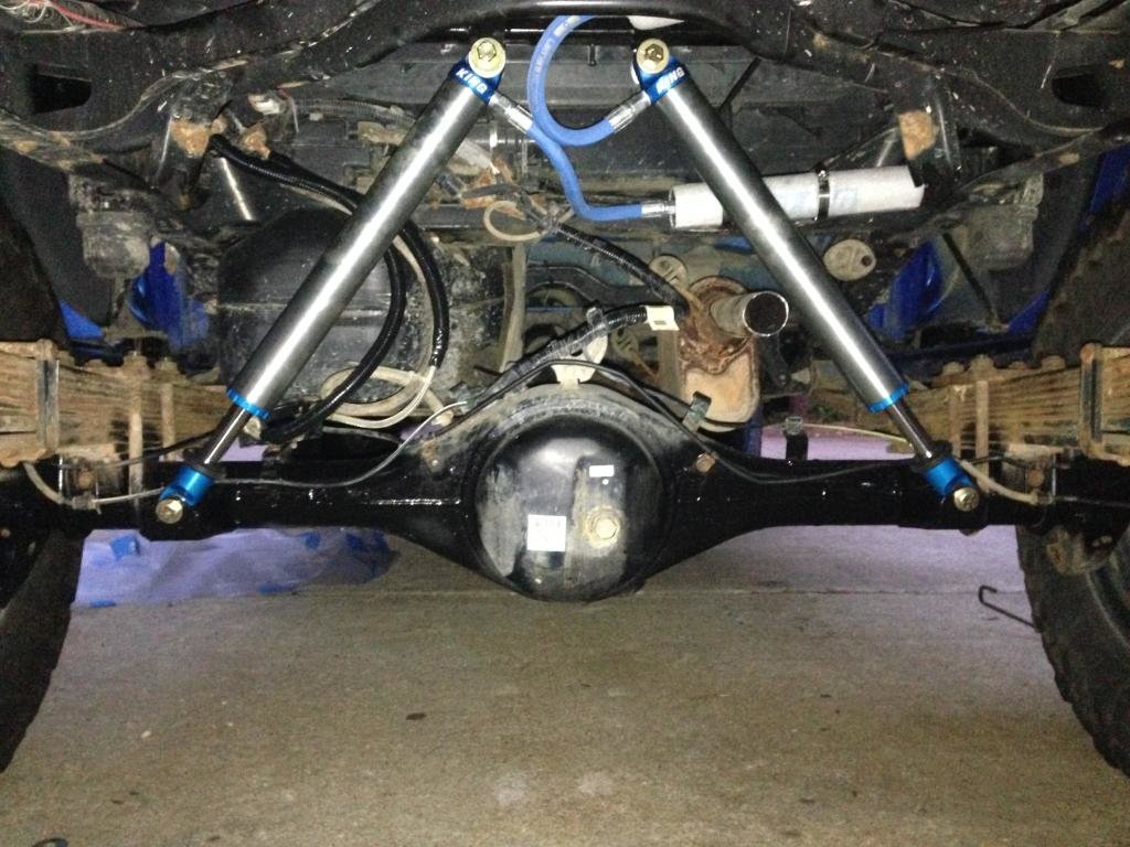

    Im surprised no one has done an inboard setup like people do on the 1st gens on the 2nd gens with the shocks like / \

    I always wondered why some trucks have shocks mounted like that..

    It's been done at least once... @PSU Taco85 's build.
