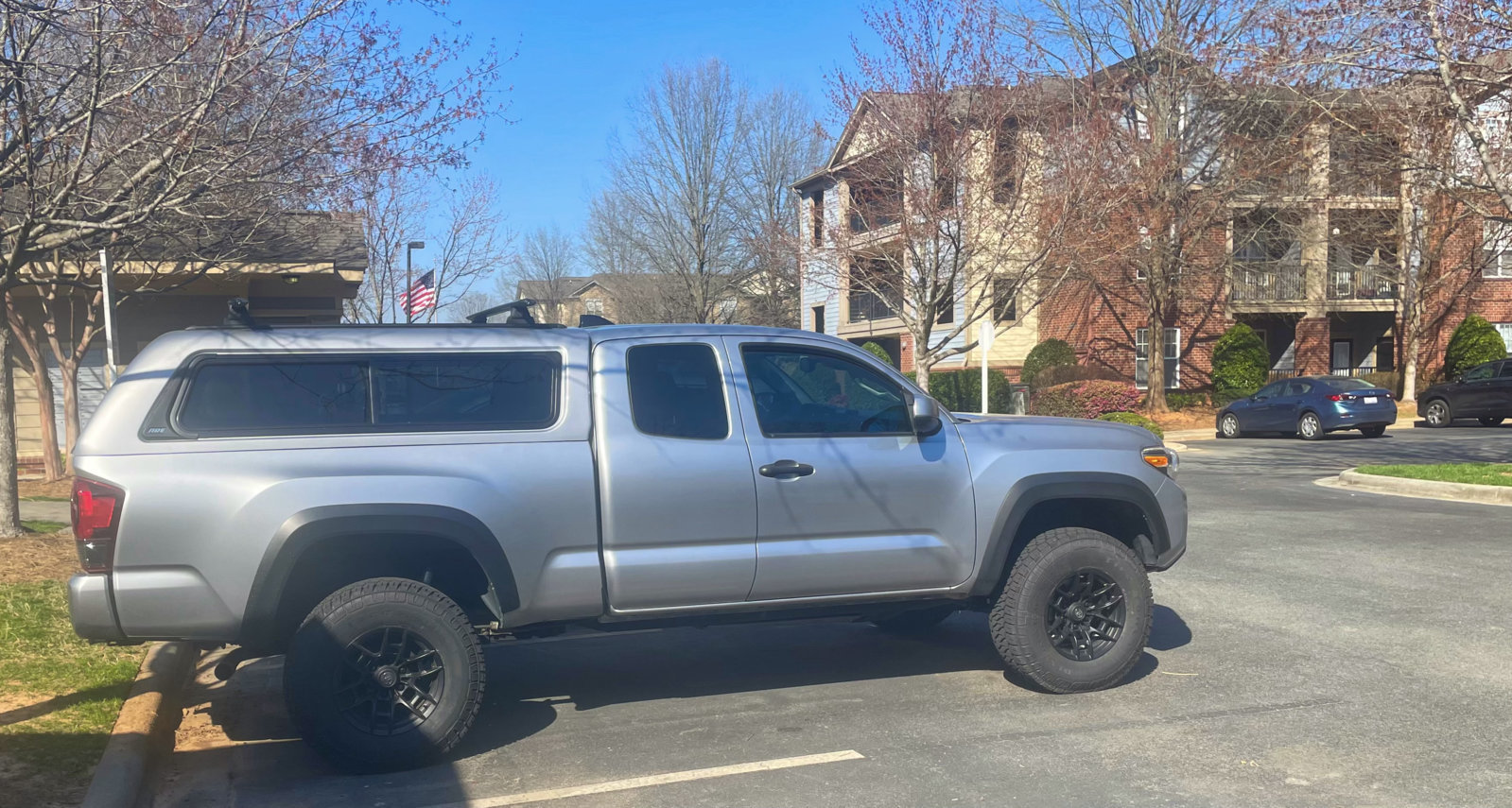

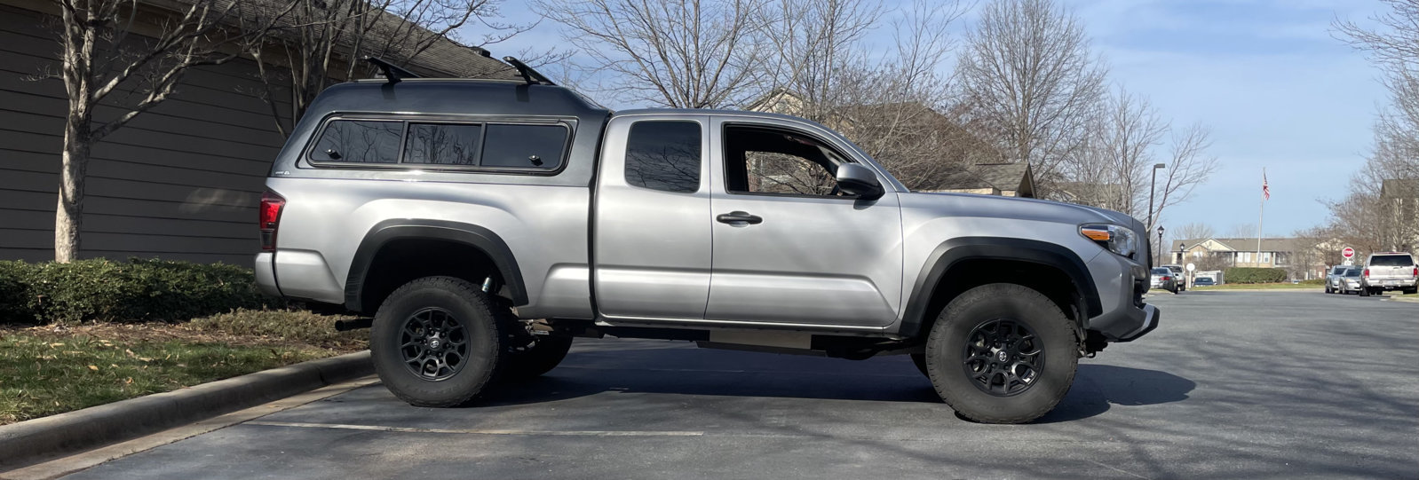

    Took a crappy pic but you get the point stock springs 1.1 lift with 5100s in the front and stage 2 pack this is with the weight of the shell plus about 350lbs in the bed i have bam beds boards and some pull out sliders with some tools and gear that always remain in the truck.

    324
    2020 MGM Tacoma SR SX Package
    See I won’t really have tools/gear in the back unless I am going camping. Who knows maybe I will end up going to option 2 but I am going to try option 1 first

    I was debating between stage 2 and 3 also but I think looking at those pics above stage 2 will be fine. I will have an Alu-cab full time and a bunch more gear when out camping or hunting but I won't have all that gear in there all the time and I don't want to ruin my ride. Hope I don't regret that and have to rip it apart again to go to stage 3 but I guess it is what it is.

    Yeah i will grab some measurements tomorrow the rear settled 1/2-1'' from when i first put the pack on its been about 10-15K took a while to settle in. I regretted going with stage 2 at first with it being too high but then it settled and im happy with it. We buy trucks to do truck stuff which is load up the bed at times. Unless you have no weight in the bed and want a lift or wanted to keep the stock height front i cant see any reason to go with option 1 especially after it settles in. This is a pic when i had just put in the leaf pack different topper but same overall weight as what i have in/on the bed now, i had not put in my front 5100's yet so it was stock front height at the time. You can see it was a good bit taller, have to keep in mind it will settle down whichever option you choose.
