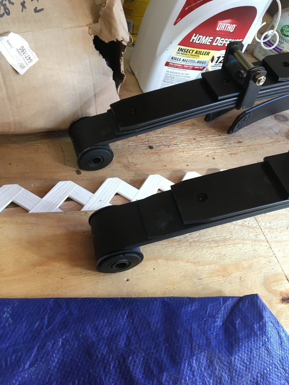

    Install instructions 2019 Rev.D definitely direct you to put the extra leaf backwards. I built one per the instructions and one per common sense before I found this thread and came to the same conclusion as you guys. See pic below for both side by side. Now to flip the wrong one around.
    Thanks for the confirmation!

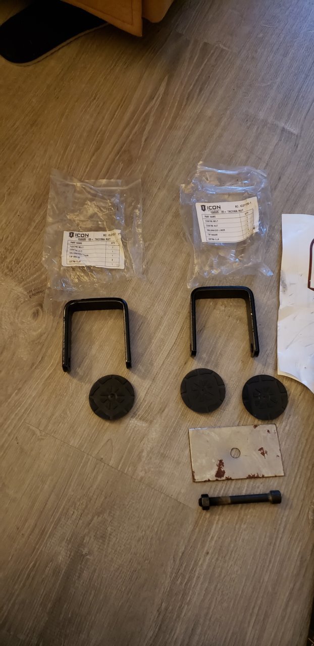

    I ordered the icon rxt leaf pack and was missing the spare galvanized liner and plastic pads for when I configure it to option 3. Does anyone know where I can order the liners?
  13. Dec 15, 2019 at 1:11 PM
    #413
    christyle
    christyle 107
    May 16, 2017
    #219225
    1,706
    Chino Hills, CA
    2014 Raptor
    ......Uh.....Icon? Just a guess tho

    6
    2013 Tacoma dcsb
    From what I read about Icon's cusomter service, I figured it would be easier to buy it somewhere.
  16. Dec 17, 2019 at 1:16 AM
    #416
    1taco2motos
    1taco2motos Well-Known Member
    Jun 14, 2016
    #189648
    381
    Colorado
    19 DCSB mgm TRD OR 6MT
    Call Icon and let them know parts were missing upon arrival.

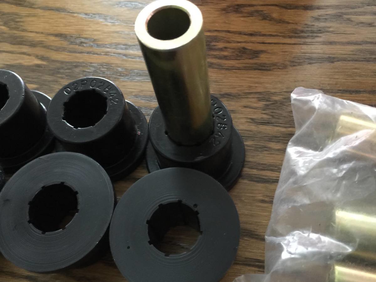

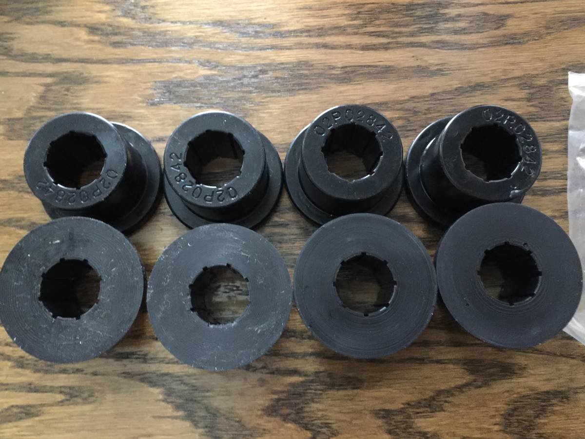

    I purchased some Energy Suspension bushings, not knowing the leaf pack already had the integrated bushings welded into them.
    Should I just keep them as is and sell the Energy bushings?
    or
    Should I melt out the stock ones and install the Energy Suspension bushings?
    Are the stock Icon bushings fine? Experienced advice with them?
    These are the bushings purchased:
  18. Dec 23, 2019 at 5:01 AM
    #418
    ARCHIVE
    ARCHIVE Well-Known Member Vendor
    Oct 29, 2015
    #168099
    2,243
    Eric
    Orchard Park, NY (Buffalo)
    '05 Taco, '22 Tundra, '91 Cummins
    2.5" Fox relocation * Hammer hanger * Archive MD springs
    The installed bushings should be zero maintenance. Also, you'll have to measure to know that the eye is right diameter (40mm/1.57") and and the leaf material is correct width (60mm/2.375") for the poly bushings
    SpeySquatch[QUOTED] likes this.

    If the measurements work out, it would be interesting to see if the aftermarket bushings keep it from squeaking.
