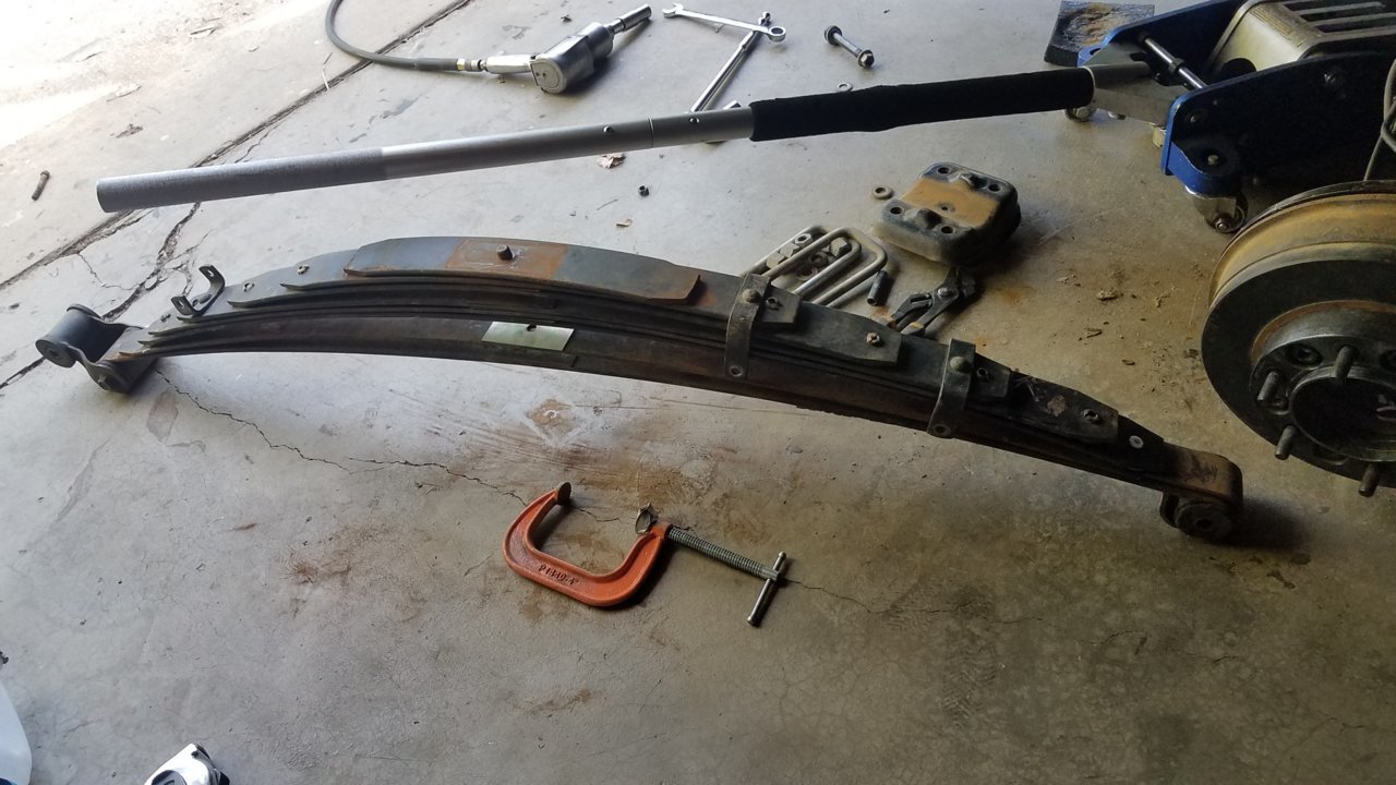

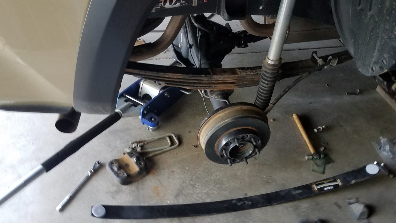

    Changed to option 3 last week in preparation for towing and camping over the weekend. Jumped me up to 25" from hub to bottom of fender in the rear. Fronts are at 23" from hub to bottom of fender. Yes, the Taco lean is real, 24" from hub to bottom of fender on the driver side rear. The ride was a little stiffer in the rear but not by much and not to the point of uncomfortable, it actually still feels better than the stock leafs. The ICON RXT are great in that they have multiple thin leaves. Yes, the optional leaf does have a specific direction it needs to be install and there was only one way to install so that the plastic pads came into contact with just the leafs also. I do recommend installing compression adjustable rear shocks if you want to control ride comfort between fully loaded and unloaded. Compared to Option 1, overall the jump to Option 3 was perfect for towing and handled the additional weight without sagging too much or ever hitting the bump stops. Ride was softer when fully loaded of course, and the ride is still comfortable for daily driving unloaded. I don't have a topper that would add additional weight and space for more gear but if I did, I think I might have to go to the Dakar HD leafs to avoid severely sagging but for now these will work perfectly.
    It was fun but I never want to do again.

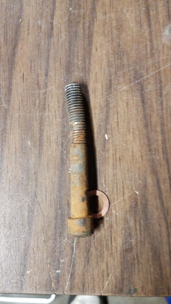

    Something's wrong with this leaf spring retaining bolt....
    Unfortunately I didn't get any good pictures of the truck fully loaded and measurements on what that sag. I'm estimating it was about 1.5" or 2" of sag when it was fully loaded.
    For reference this was last year on option 1 which I didn't plan for.

    Curious what makes you think it’s wrong? Wouldn’t you want the military wrap on the fixed pin and not the shackle? At least that’s how I installed mine. Would love to hear feedback on this.
  5. Jun 16, 2020 at 8:49 PM
    #525
    BearWithMe
    BearWithMe Well-Known Member
    Jul 7, 2018
    #258617
    591
    Four Corners
    2025 OR 6MT Celestial Silver
    Prior: '18 OR 6MT
    The issue is with the 4th leaf from top, the optional add-in leaf. Notice how the end of that leaf isn't staggered in length like all the other leaves. That's because it was installed with the front end at the back.
