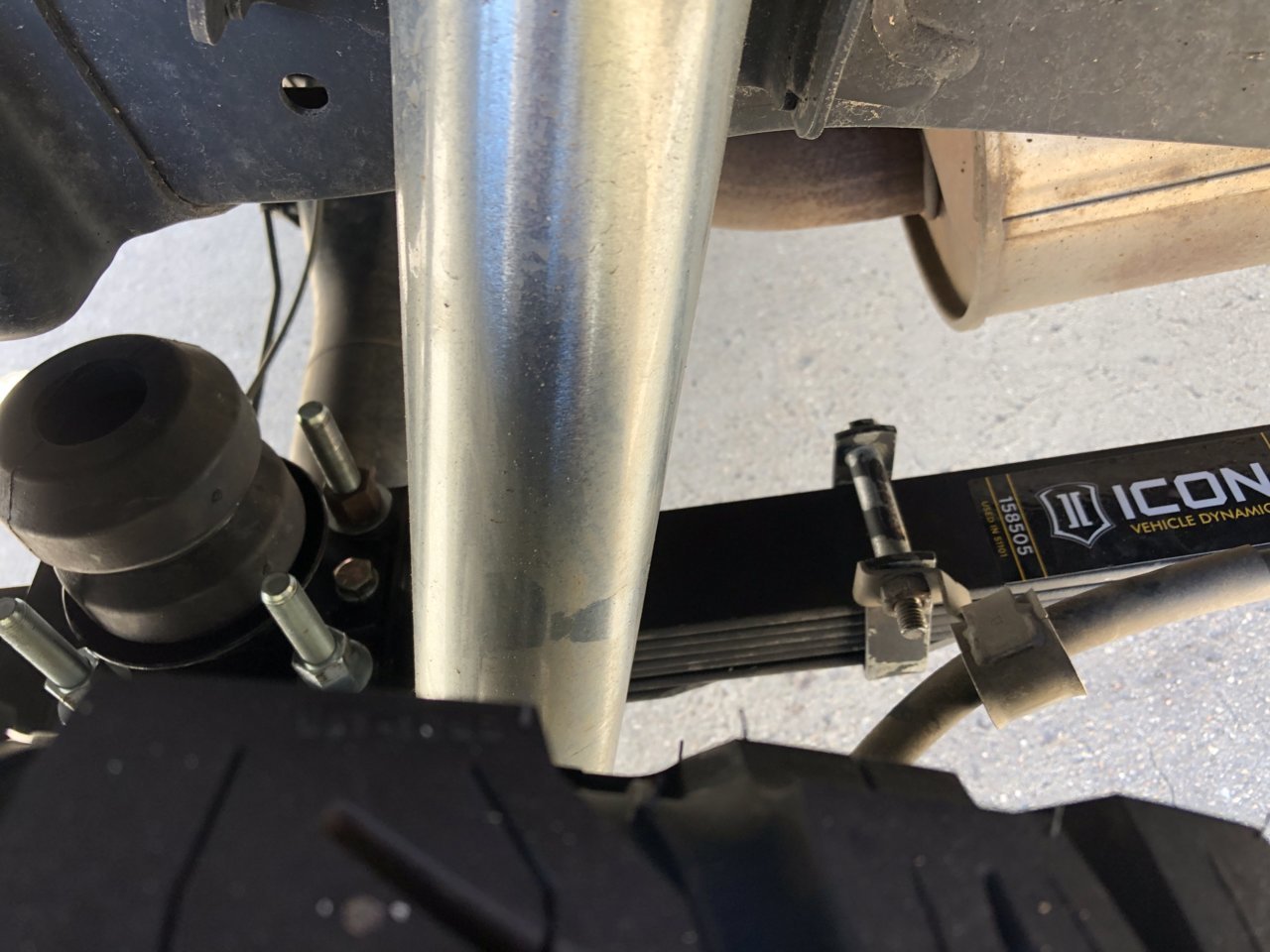

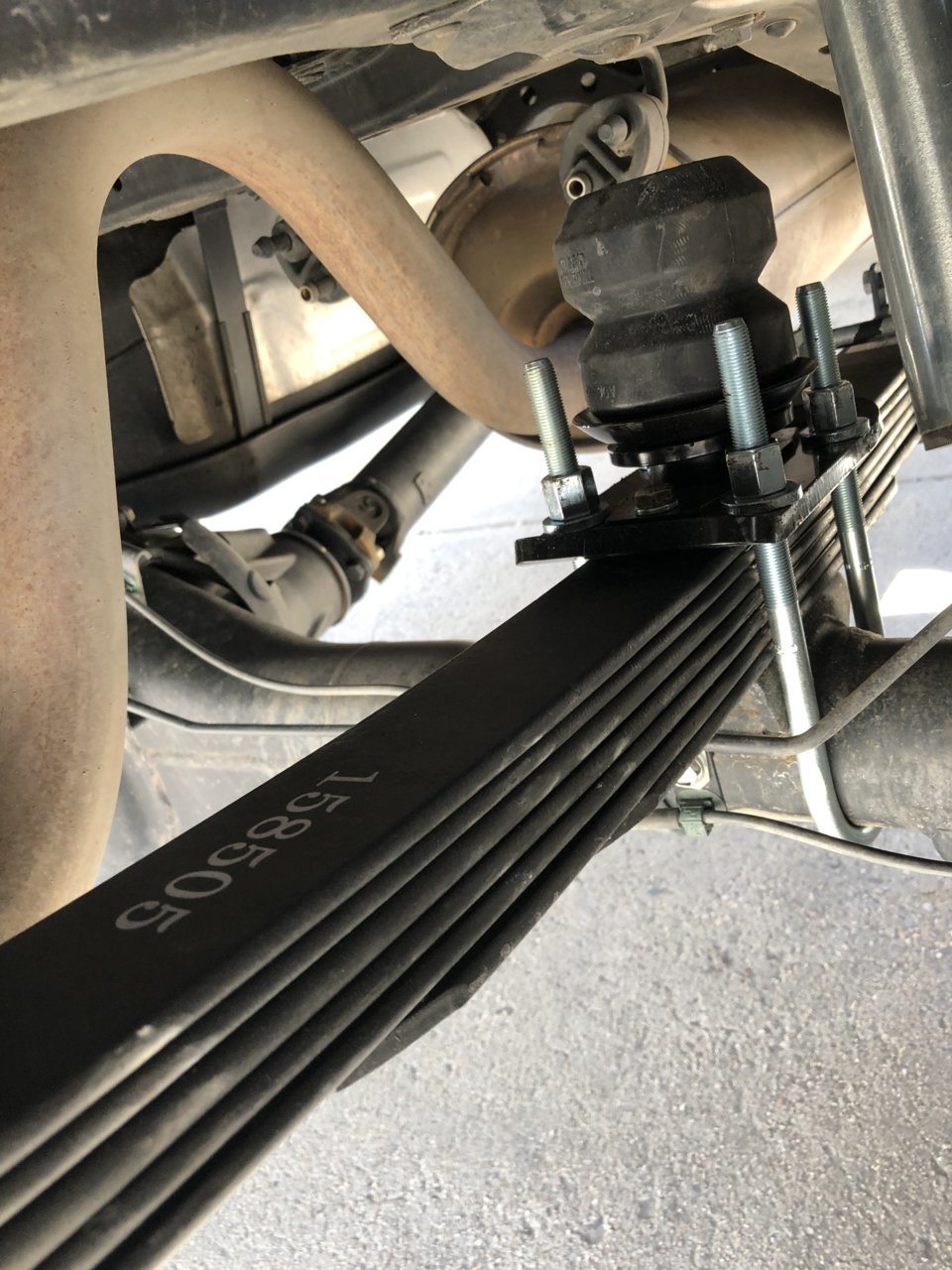

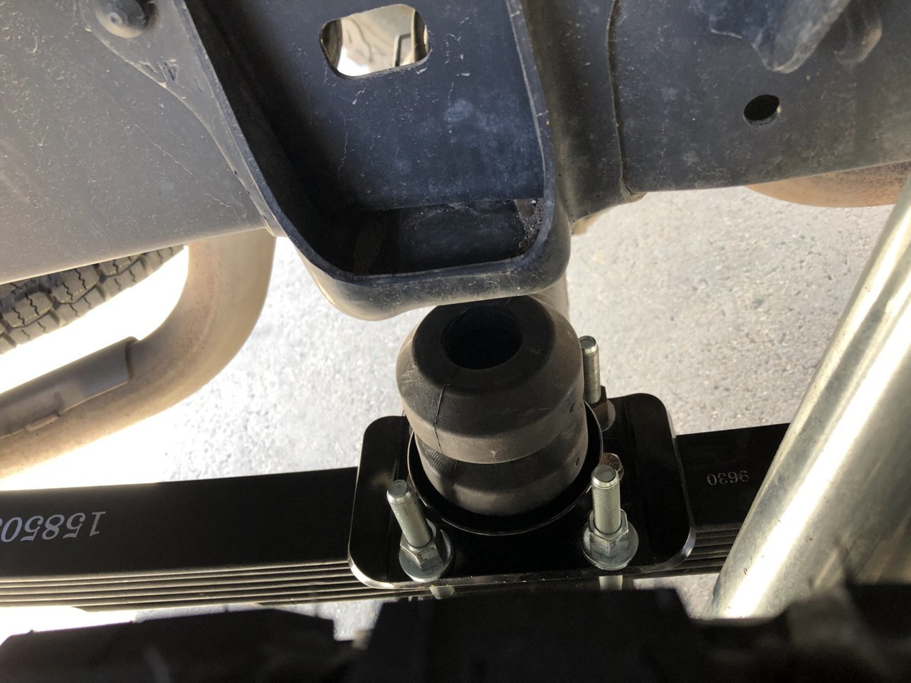

    Finally had a chance to get the RXT leaf pack installed today. Went with option two and Timbren Off-Road bumps. I've only driven about 10 miles on city roads with the new setup but man do they feel great! Night and day difference between these and the AAL i had on before. Not sure how much the bumps are helping but from the short ride I took today my ride is a lot smoother. Fronts are 23 3/4" and passenger rear is 24 1/4" and driver 24 1/2" from center hubs to fenders. Now all I need to do is cut the u-bolts down about an inch and get some bumps for the front.

    Careful not to cut too much like I did. I cut them flush with the cup of the bump can and then installed a degree shim later and the extra thickness means they end just below the top of the nuts.

    I thought about that. That's why i'm only cutting an inch off.

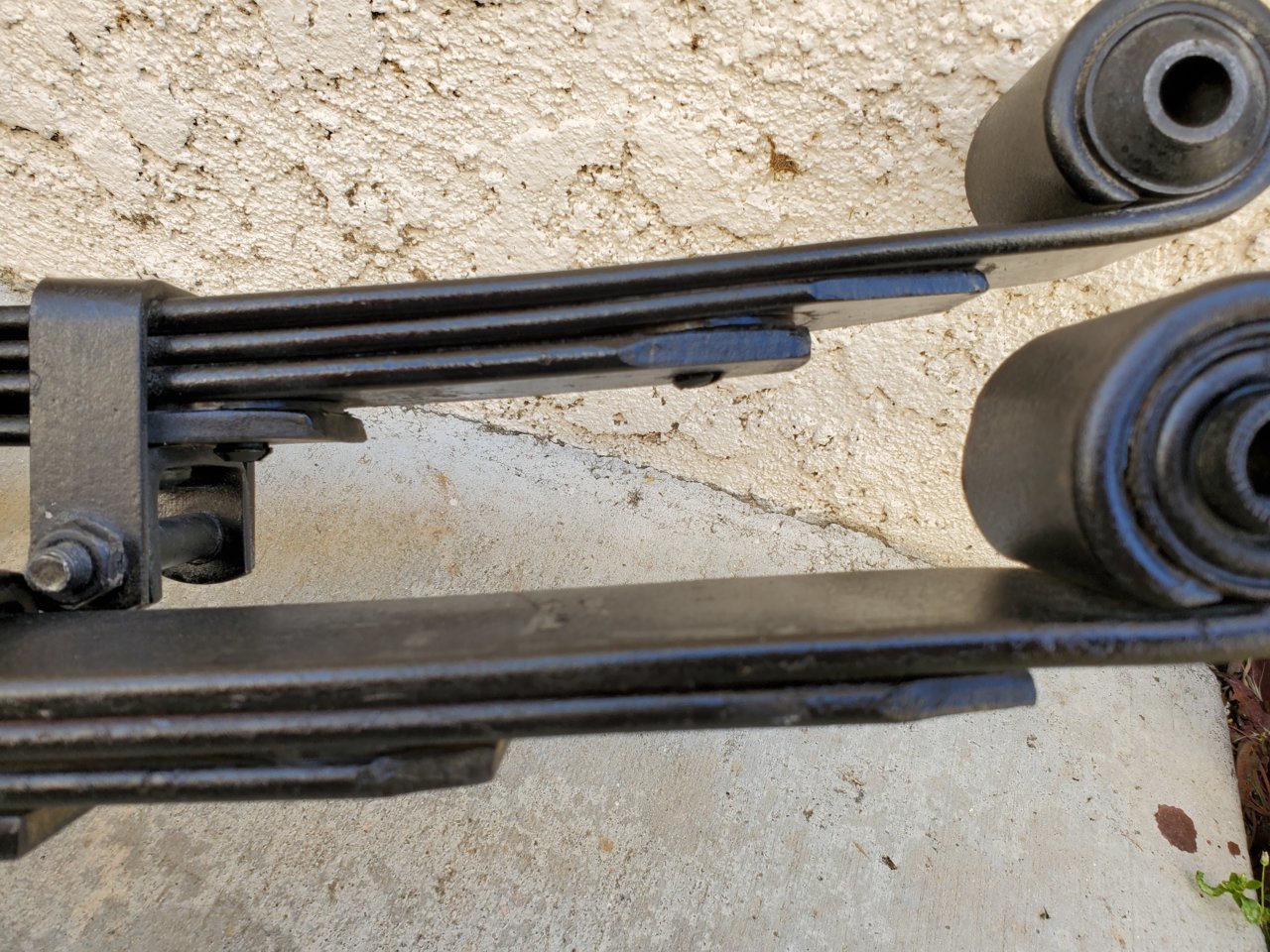

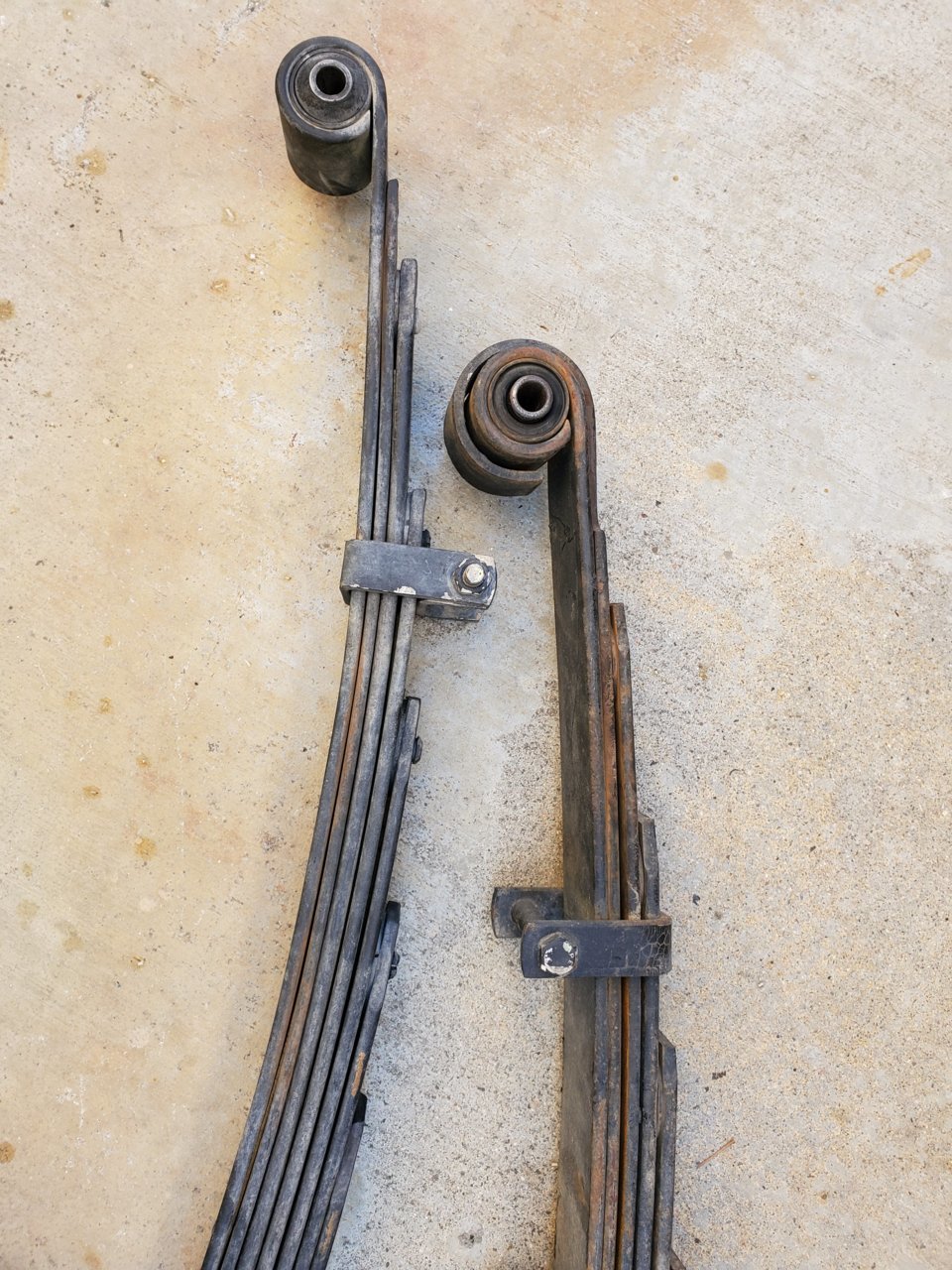

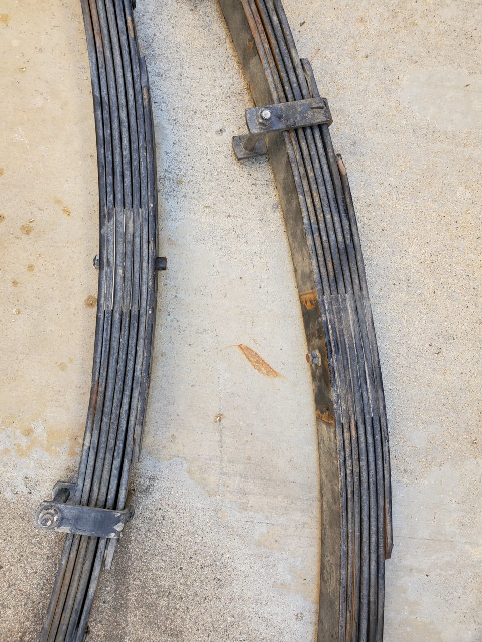

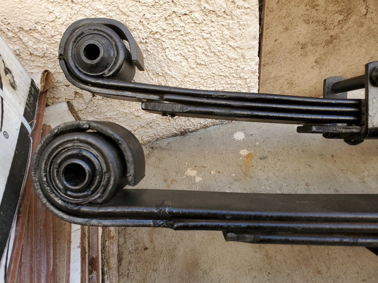

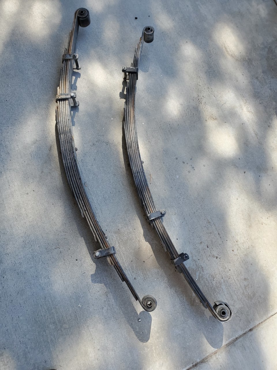

    alright so i picked up a set from the Icon garage sale but I can't tell if it's got option 1 or 2 installed.
    Here's pics if anyone can chime in...thanks

    Looks like option two Rob.

    It’s definitely not option three since yours only have 7 leafs. The 3rd leaf from the top looks like mine and I’m rocking option two. Hopefully a couple others can chime in to confirm.

    I'm assuming the aal they include is longer than the option 1 leaf?
    A second confirmation would be awesome.
    I painted em for pretty sakes right now. Lol

    Yep, the aal is longer than the leaf that comes with option one. That’s why I think you have yours setup as option two. I’m 99.9% sure based on the photos you posted. There’s another icon rxt leaf thread I believe under the 3rd gen Tacoma thread called “icon rxt leaf pack help” or something along those keywords if you want to post there to have someone else confirm if you have option two. Doesn’t hurt to get a couple opinions.

    FYI.. just measured the leaf for option one and it is 46 1/4”. That was the third leaf from the top before I swapped out the aal.

    Well I think I have one of each lol.
    I measured one close to 46 but the other 3rd leaf is 51 ish.
    I also noticed the taper length is different too.

    Not good
