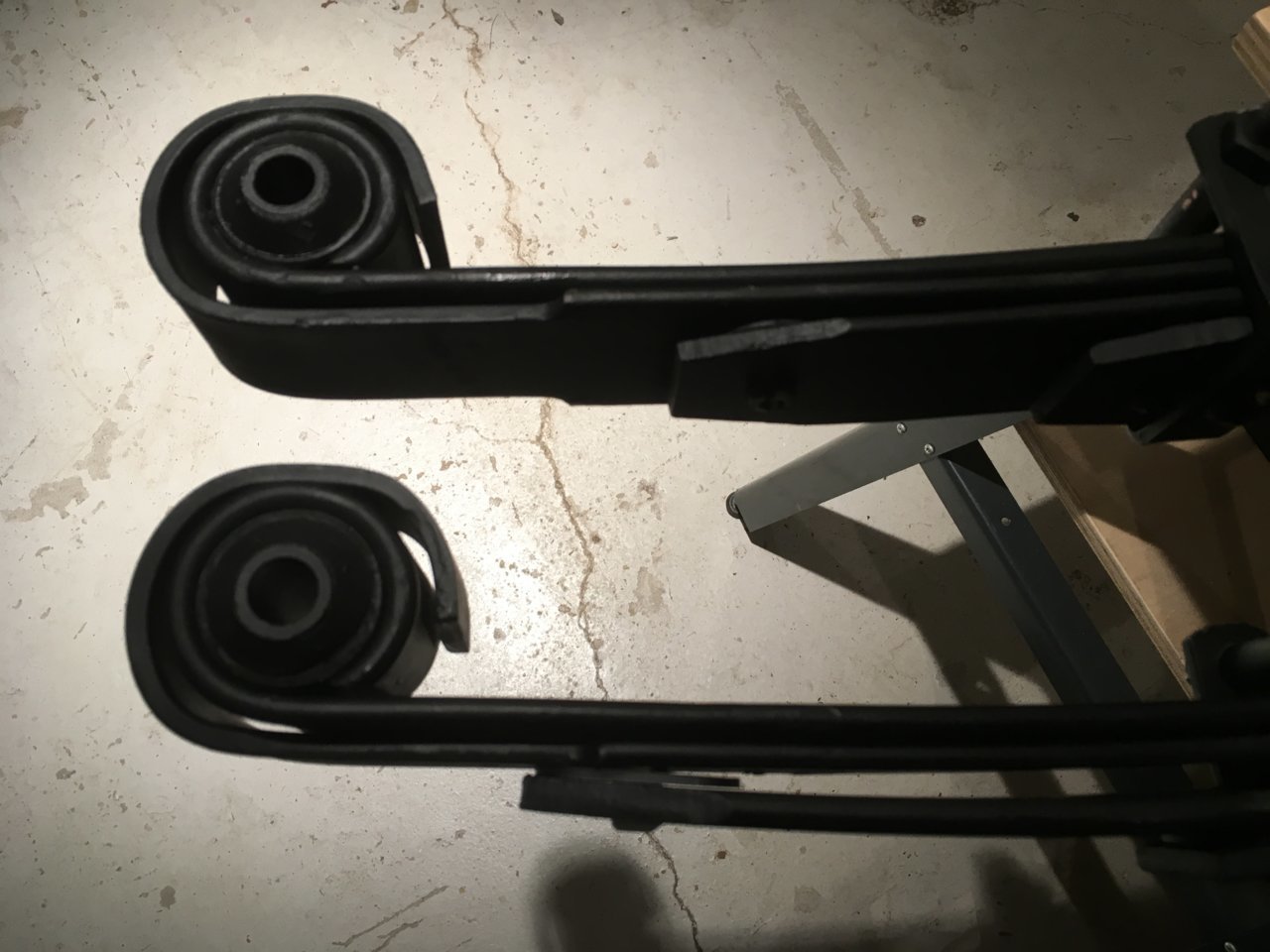

    alright so i picked up a set from the Icon garage sale but I can't tell if it's got option 1 or 2 installed.
    Here's pics if anyone can chime in...thanks
    @Daddy_Firebird is certain it's option 2 but if we can get a confirmation that would cinch it.

    well...we know it’s not option 3 (7 leaves rather than 8)
    post a pic of both front eyes aligned next to each other for comparison to my pic
    where the top spring is as shipped at option 1 - bottom spring I just adjusted to option 26B8D2948-44DC-42AF-A75C-48B0DDB17DD9.jpg

    I definitely ended up with 1 of each :(
