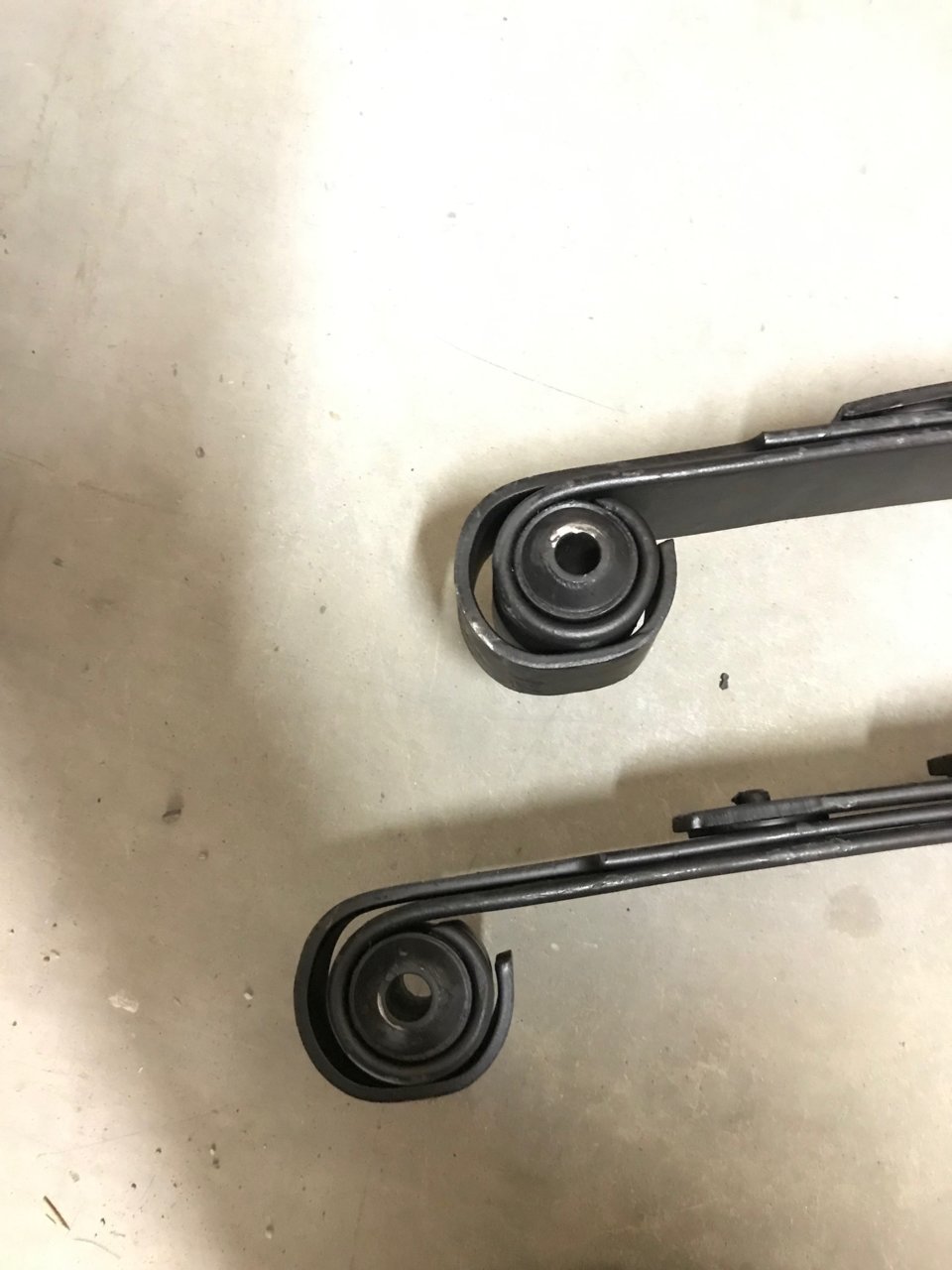

    For those who have reassembled these springs, how much leaf overlap is within tolerance? Some of the leaves are just slightly off and its a bitch to get them completely even.

    Aligning the sides of the leafs?

    Yes

    I just got mine as close as I could...the leaf widths are all slightly different - won’t be absolutely perfect. Tap sides of leafs to align before tightening.
    Should be within a fat 1/16” of each other...?

    Yeah use a dead blow or rubber mallet to get them close after you get the center pin in, but remember they will naturally move once installed. So its not a big deal (even tho it drove my OCD nuts haha)

    Thanks I thnk I got them close enough after a couple hours of tweaking on them. The second set went much faster and practically fell in line.
