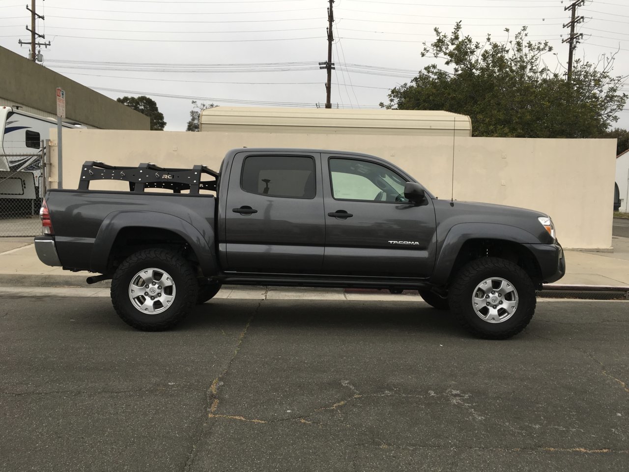

    hi
    the front has bilstein 6112's set on the 4th notch for advertised 2 1/8" lift.
    i've had them since april - they've settled 1/8".
    my rxt's are installed at option 2 - rake is just a bit more than the stock rake which i want because i carry a camping load.
    when i'm loaded out for camping at about 600# it sits about level.
    love the ride front & rear unloaded or loaded.
    tires in that pic are 265/75/r16, but next size will be 285/55/r16.
    sounds like your 2.5" lift in front coupled with rxt's at option2 will still give you some rake, which to me is a good thing.
    let me know if you'd like hub to fender measurements.
    dave

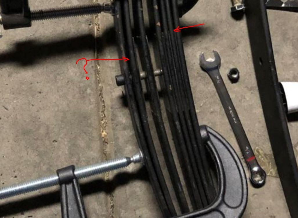

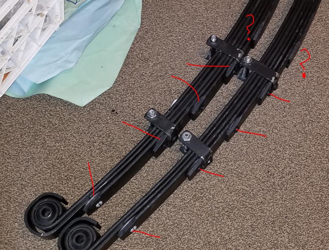

    I am surprised that the bottom blade does NOT have any pads and no brass spacer in between like the other blades. Also, why is a spacer between the very top blade and the second one?
    I removed all of my brass spacers when I installed the RXT pack and now I have a squeak. Will drop the pack and rebuild it soon with custom brass spacers and better plastic pads.
    Should I drill holes in the last blade and put plastic pads in there? Any reason why is none from the factory?

    Im sure there is a reason. Those lower springs are always in contact with the ones above it, they dont move much, theres likely a lot of load on them.. Im spit balling here, but I wouldnt rush out to change their design until you confirm that your noise issues are from the leaves themselves, and not the bushings or something else
