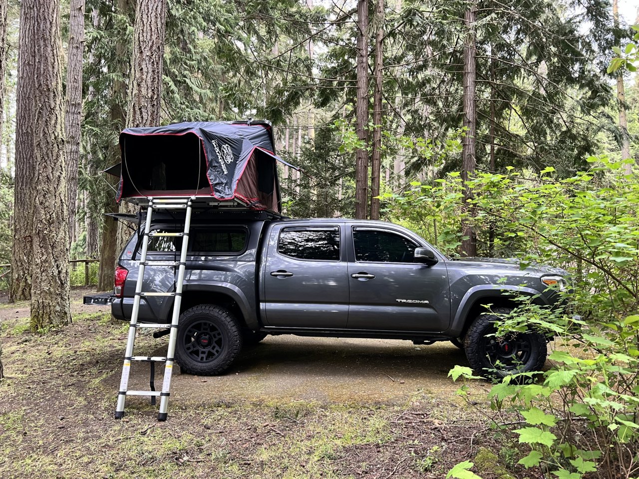

    I run option 1 with a leer shell and ikamper rtt. Up front I have the stock OR shocks with a ¼” spacer. Ride is crazy smooth. Still has rake. Love it. B6244450-6962-4AD8-991D-77E6862B2876.jpg

    Option 1 with all that weight? I'm surprised you still get rake. That's gotta be like 400lbs back there? Did you install them recently? I had great rake but it settled well. Little too well. I was about level with maybe 200lbs back there. Option 2 gave me some rake back.

    They’ve been on for about 3 months. They settled a bit.
