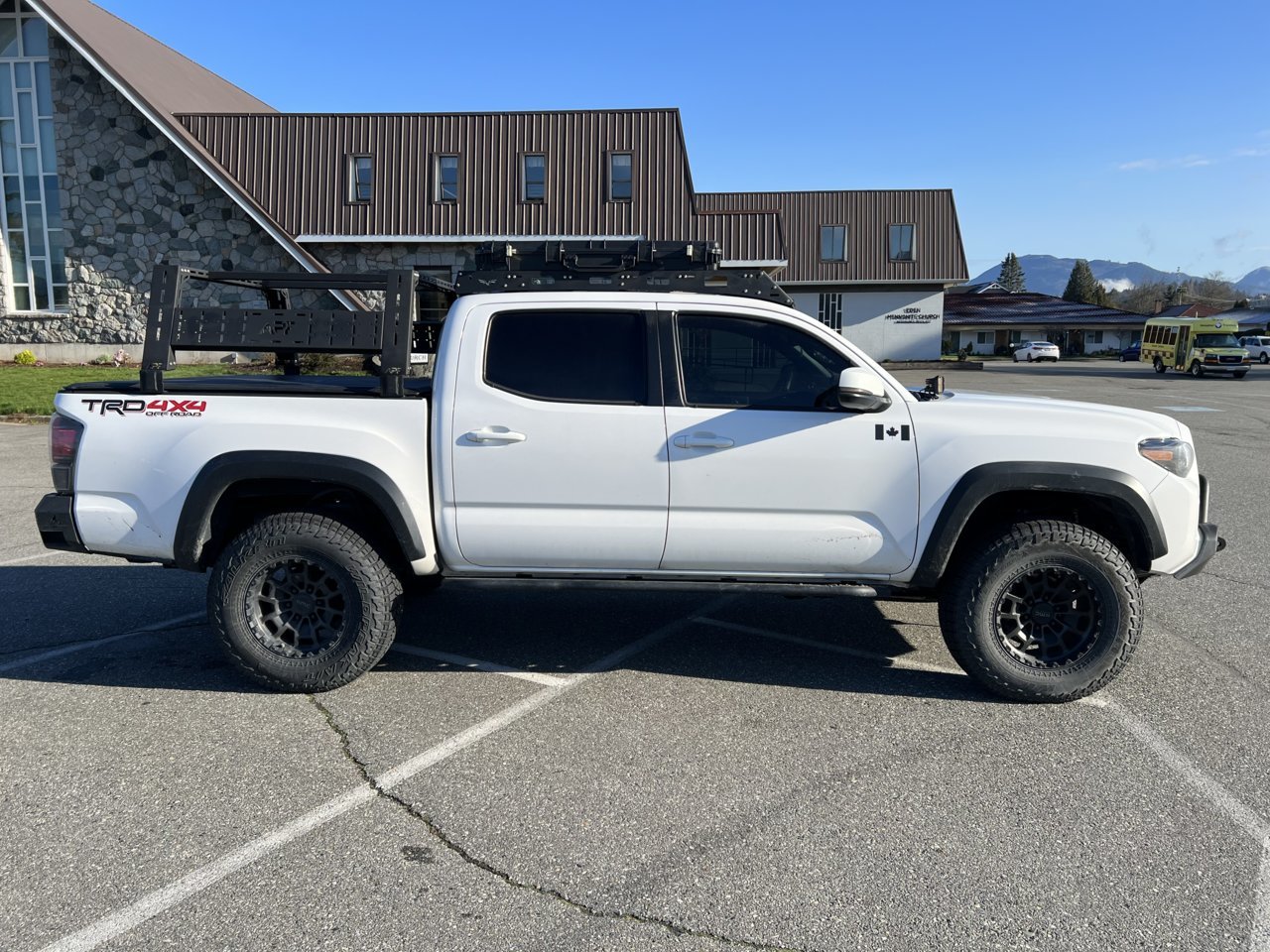

    I’m in the same boat as you right now. Looking to switch out my All Pro standard 3” leaf pack for Icon RXT leafs. The new leafs have been shipped and I should be receiving them sometime next week. I’m swapping these All Pro out as the leafs have gone flat, sag with any weight I put in the back and seem to have a harsher ride. I installed them 2 years ago and they have been squeezing like a MF lately and I’ve lost alot of my lift height. Measurements from hub to bottom of fender is 22” in the rear and 21.5” in the front. I plan to raise my front coilovers up a bit. I am using a Timbren u-bolt flip kit with them and plan to reuse them with the Icons.
    My question is do I go with option 2 or 3? I am running Elka 2.5 with resi all around and have 700 lbs coils up front. My truck currently sits level with the sagging All Pro but I want to regain my rear lift height and have a bit of rake. I have front and rear steel bumpers with a winch, full size 33” Wildpeak spare in the factory location, full RCI steel skids, gas tank and rear diff. Steel sliders and a steel bed rack. Planning to add an RTT this summer. Most of the time my bed is unloaded until I go camping and I add 300-400 lbs. What option would you recommend?

    you want rake or no?
    your tent/rack/sliders are approx 300lbs. my guess is that youll be pretty level unloaded on opt 2 with. loaded youll squat a 1/4-1/2"

    Yes I’d like a bit of rake. I’m looking to raise my coilovers another 1” and I’d like the rear to sit higher.
    Good to know. Part of me is saying do option 3 for the height but I don’t want it to ride too stiff. The other part of me says do option 2 but I might be disappointed in the height once I add my RTT and gear. I’m looking to do this install once :goingcrazy:

    it wont be too stiff. it will ride better than it did from the factory or with an AAL. i run opt 3 with sliders, a tent, and a rsi topper. the bed is empty 3/7 days of the week. my measurments from my garage floor to bottom of fender are 39.5" and im on 33's

    ^I'm on option 3 and it doesn't ride stiff. Rear still flexes more than the front on trails, despite a sway bar delete.
    I have a tonneau cover and steel bumper, about 120 lb over stock when unloaded.

    Good to know. Thanks. I think either option will ride better than my current All Pro leafs.
    Do you guys happen to know what the distance is from the center of your hubs to bottom of fenders are? It’s a more accurate measurement then from ground to fenders.
