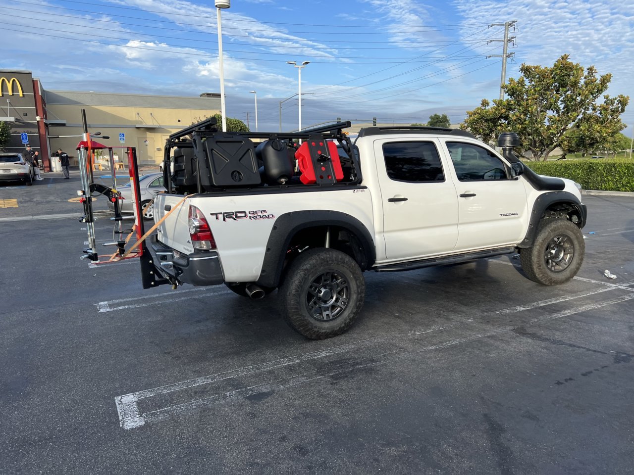

    You will have to add up the weight of your add ons for a comparison but for reference I have:
    leitner rack: 120lbs
    2 3g rotopax: 40lbs full
    Decked drawers with gear: 300lbs
    33” spare: 75lbs
    Rock slider: 100lbs
    Full steel skids: 210lbs
    Hitch mounted spring compressor: 90lbs
    I have RXT option 2 with a 2.5x12” shock (not that shock length affects ride height generally) and hammer hangers
    Sits nice and level with the 2” front lift after settling and rides really nice
