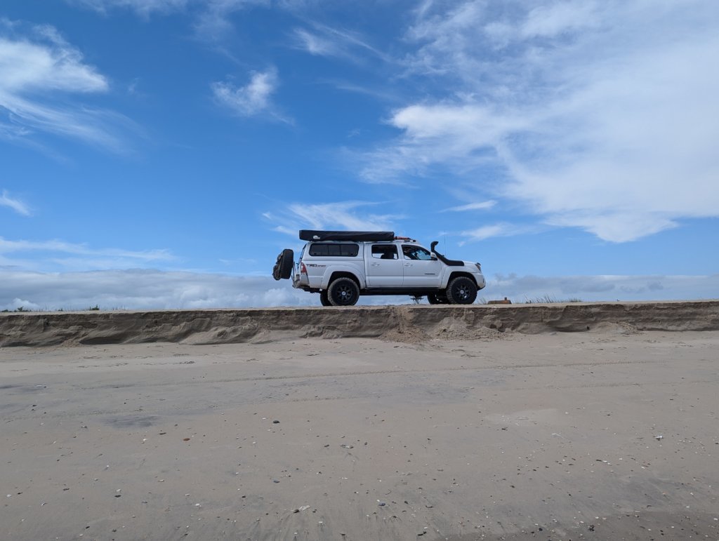

  12. Nov 7, 2024 at 10:12 AM
    #232
    Chase8059
    Chase8059 Kinda Well-Known
    Jun 4, 2015
    #156733
    3,259
    Chase
    ESVA
    2015 DCSB TRD Sport | Super White : 2008 Lexus IS 350
    OME 887, JBA UCAs, 1.5 AAL, Fox 2.0 RR w CD adj., SCS SR8s Gunmetal, Falken AT3/W 265/70r17
    So during the 3.5yrs running stage 2, I've added a fiber glass topper and aluminum bumper with swingout. My front coilovers are also on minimal preload so I'm going to have these adjusted a bit, and want to prevent any negative rake by lifting the rear a tad more.
    I've calculated my beds static load is now:
    Bumper: 75
    Shell: 200 (just ball parking)
    Spare: 24+58= 72
    Bed platform: 40
    Awning: 40~
    Also running mobtown steel sliders, and miscellaneous gear in the bed but nothing crazy.
    Total: just shy of 400lbs
    I'm thinking I should go ahead and swap to stage 3 to gain some lift back, and offset and potential sag the leafs have gained over the years. Is there anything I should be aware of when doing this?
    PFA
    Bikinaz likes this.
