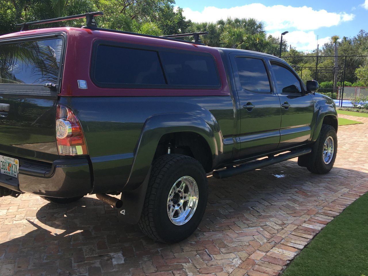

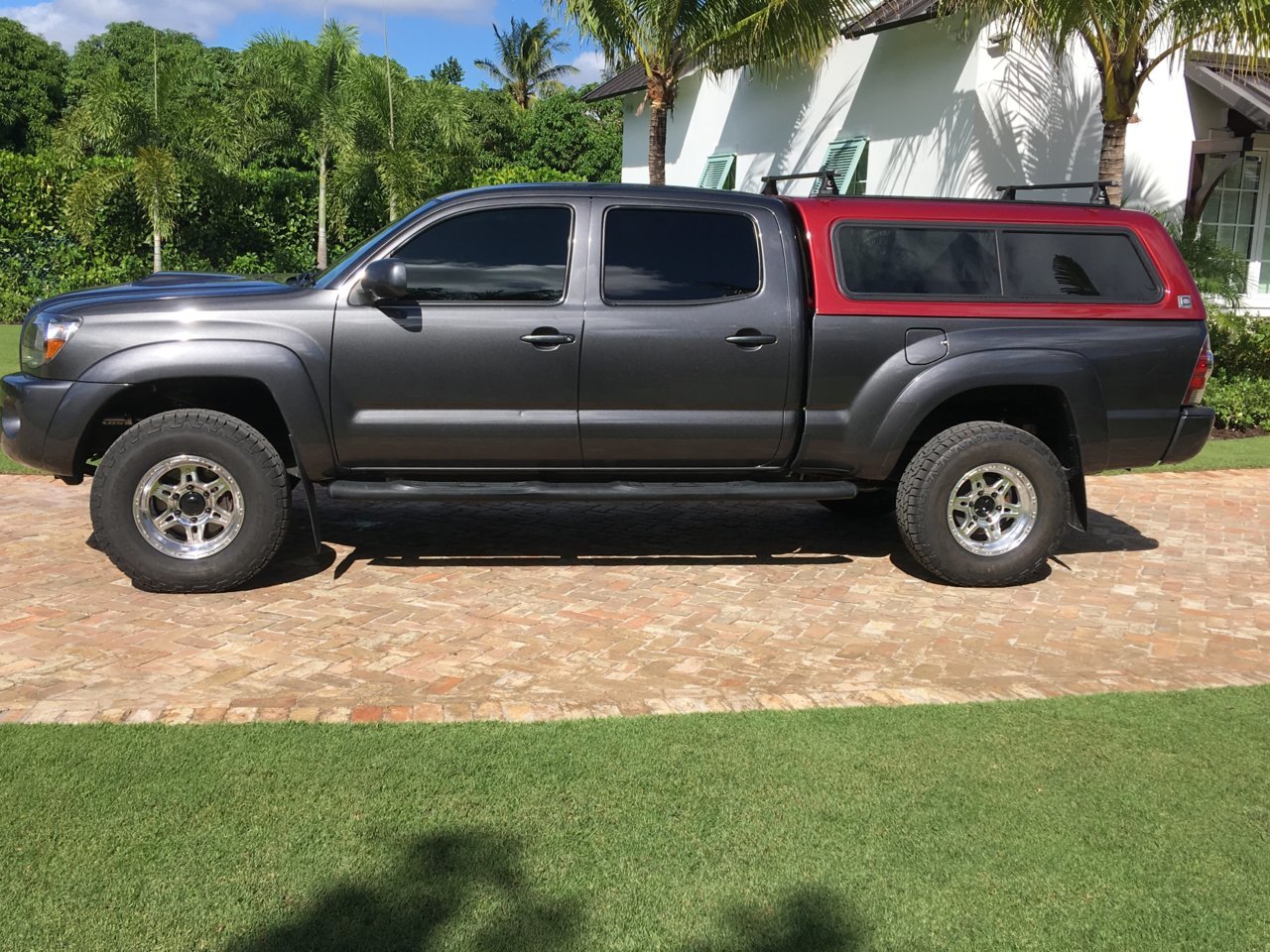

    209E1978-414C-4161-ACB5-AC40D657F4C1.jpg 1CF61990-996F-4220-95E4-50C5BB96C1BB.jpg Heres a pic of mine set on option 2.

    Looks good man! What size tires are you running and how much lift do you have up front?

    Running 265 75 16 and front is 2”. Hub to fender is 22” dr and pass. side
