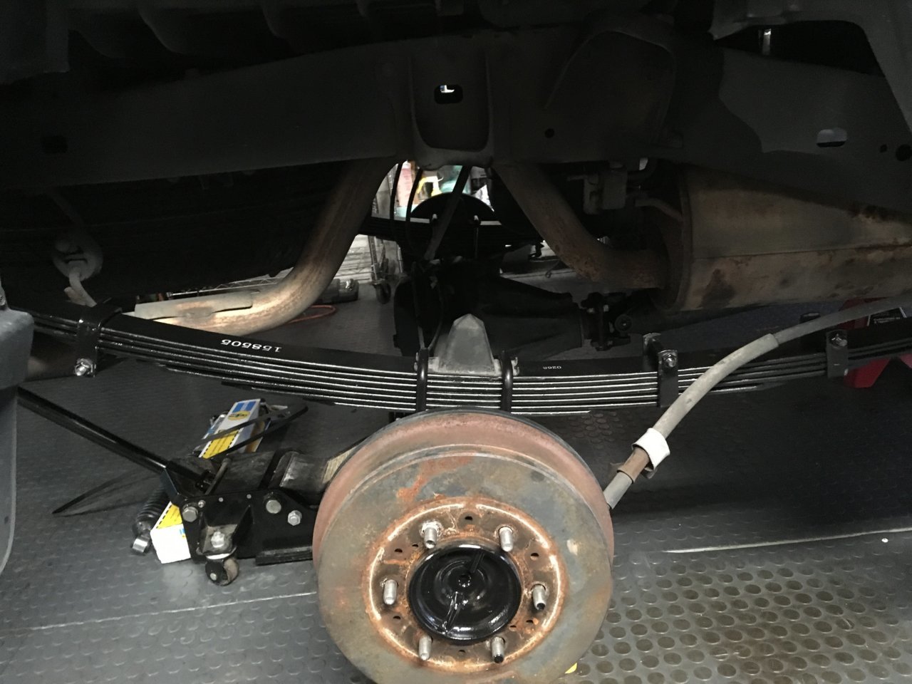

    2018 DCSB OR 4x4 MT
    Which end of the leaf pack is the front?

    Wet Okole, Maxxis Razor (285x70x17), Bilstein 6112, RXT's Fn 5star
    Heres a pick of mine on the trk

    #178058
    129
    2018 DCSB OR 4x4 MT
    Just to confirm, it is the end where the second leaf curves over the first leaf goes forward?

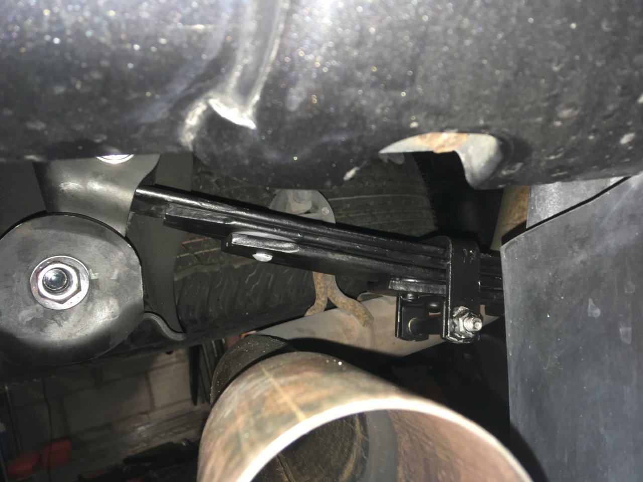

    Yes. The front half of the leaf pack has the 2 leaf stays(guess thats what their called), they look like a ubolt and open end up. Their is only one on the back half of the leaf and it has the open end facing down.
    Here is another pic of back of the leaf wheee it attaches to the shackle

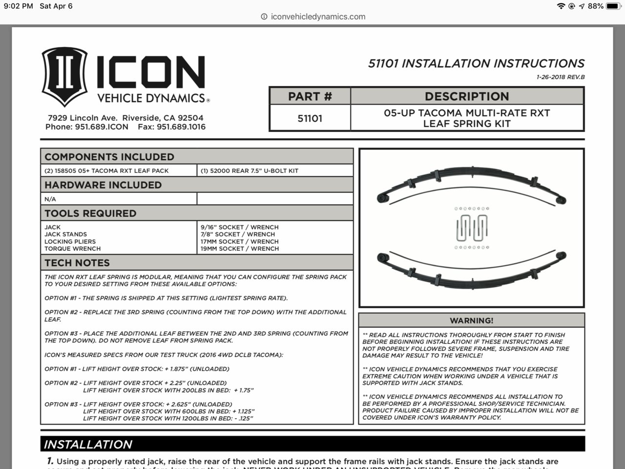

    Just picked up the leaf packs today...have a question off the bat.
    ^^^this (from a respected vendor) says they are shipped at option 2, however this screenshot from the directions on icon’s website says they are shipped at option 1...has something changed :notsure:

    95
    2017 Tacoma TRD Offroad 4x4
    If you read right next to “Option 1”, it says they are “shipped at this setting”.
    You need to swap out the third leaf to get to Option 2, and add the leaf to get to Option 3.
