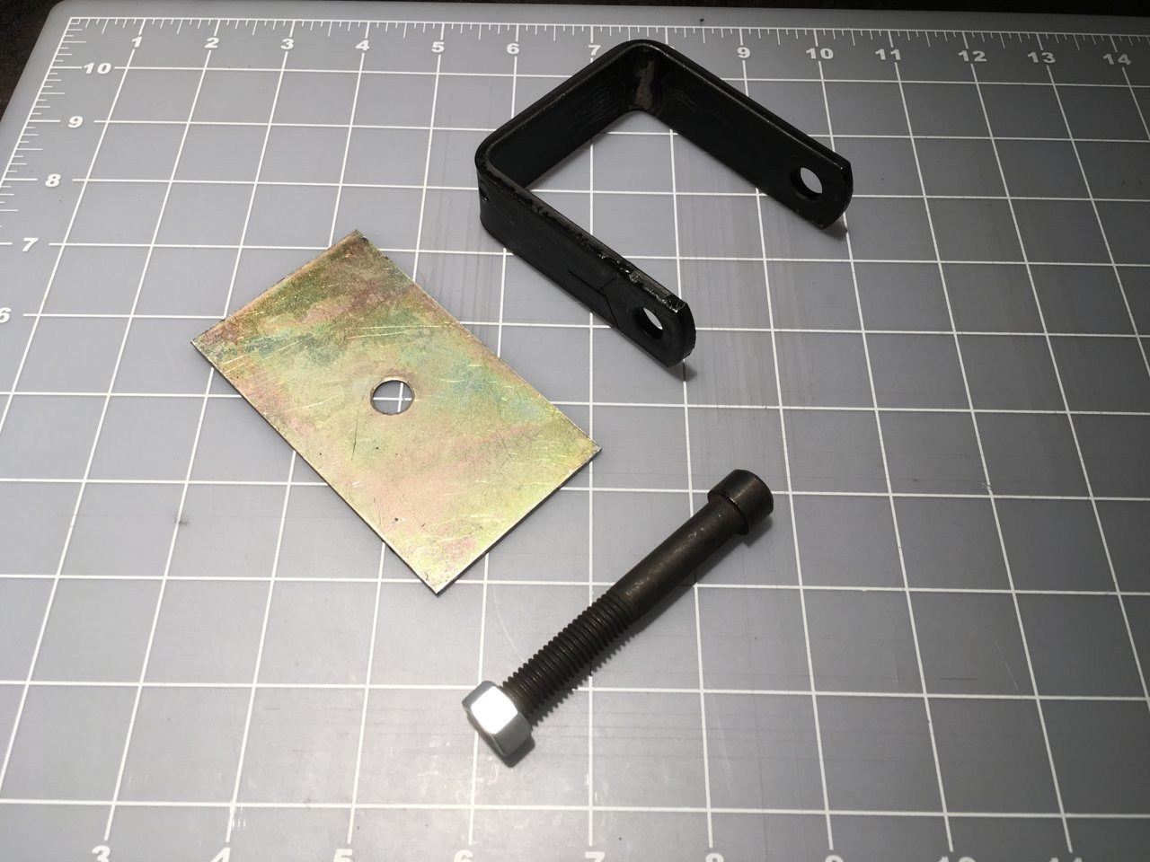

    3A19FC82-54B8-408C-A786-A4EC00069558.jpg Questions...
    Did your leaf packs include 2 each of these parts?
    Are these parts perhaps for option 3?
    The install instructions are vague, but they do say “longer clips are provided for additional pack thickness”....but the bolt included is a center pin (not a clip bolt), and is the same length as the pins installed in the packs...hmmm

    130
    2018 DCSB OR 4x4 MT
    I used the longer bracket and the liner (for the extra leaf) for option 3. You are right about the extra bolt, it is the same size. I'm guessing they provided an extra set in case you cut your original ones shorter.

    I’m running them at option 3; extra leaf added for heavy trucks.
    High clearance rear with double swingout, jerry cans, and spare tire
    Camper shell
    Bedslide
    Double loop on the leafs goes forward.
    Extra clip and flat plate are used only for option 3. Orientation of extra leaf will only look “correct” one way, it will match the stair-step pattern of all the others.
    C-clamps make rebuilding the leaf pack much easier, as does a socket for the nut and vice grips/channel-locks for the pin. I also used a punch to help align everything.
