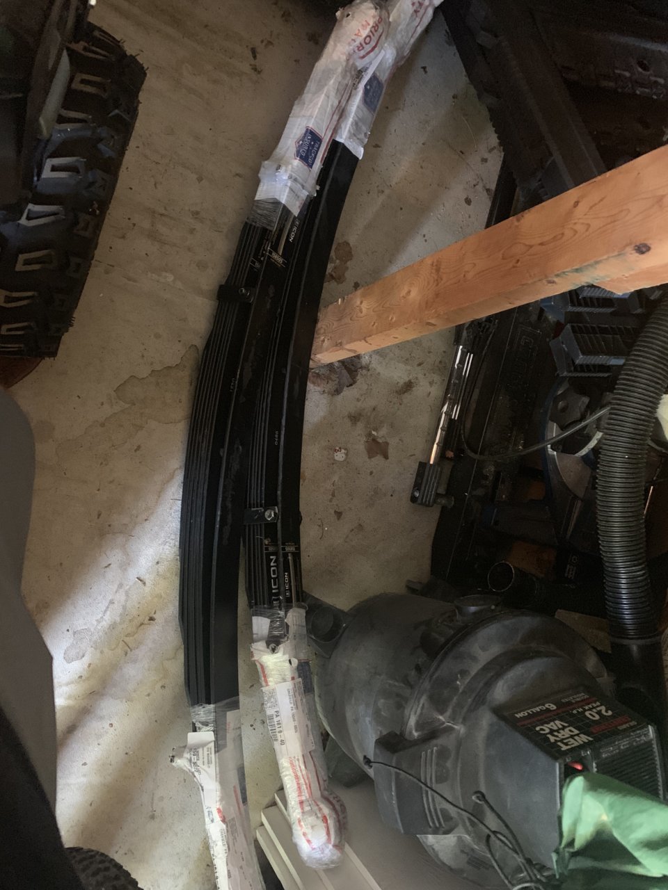

    If anyone is interested in these, I have a brand new set I'm willing to sell for $600, but have to pickup/meet, Allentown, PA areaVARJ2RG5TVSnAitNMgHcKg.jpg0JErX6+bSayPPcBeEOS5fw.jpg

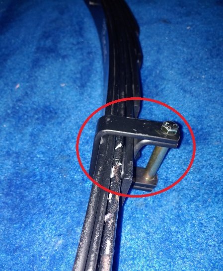

    For those who say they are running option 3 (addition of the loose leaf) for 8 leaves in the pack, how did you get the rear binder together? Mine was darn near impossible replacing the 3rd leaf with the loose leaf.

    This is how I did mine. Option 2, though, so it was presumably not as tight.

    I know how to change leafs, that's not what I'm saying.
    There is physically no room to add another leaf that is .238" thick (according to my leaf and my calipers, i just measured) in the below picture.
    Is that part supposed to be left off?
    @Icon_Adrian any thoughts on this?

    Sorry for the confusion. Didnt you get different clip included in your pack? I think I got a longer one(or deeper) for use with 3rd setting.

    no, i did not. 2 leaf packs with 7 leaves each, 2 additional slightly thicker leaves, 4 U-bolts, 8 U-bolt nuts.

    Yeah it should have came with these.

    dagnabbit!
    fooking Amazon.
    That answers my question. Thanks. I dont anticipate using all leaves at once, but if I paid for something, I want it.

    Yep I ordered from @Wheeler's Off-Road Inc . Like that post said, the instructions are a bit vague concerning the included parts. I didnt need the longer clip since I just swapped out one leaf for the thicker one. I'd call Icon.
