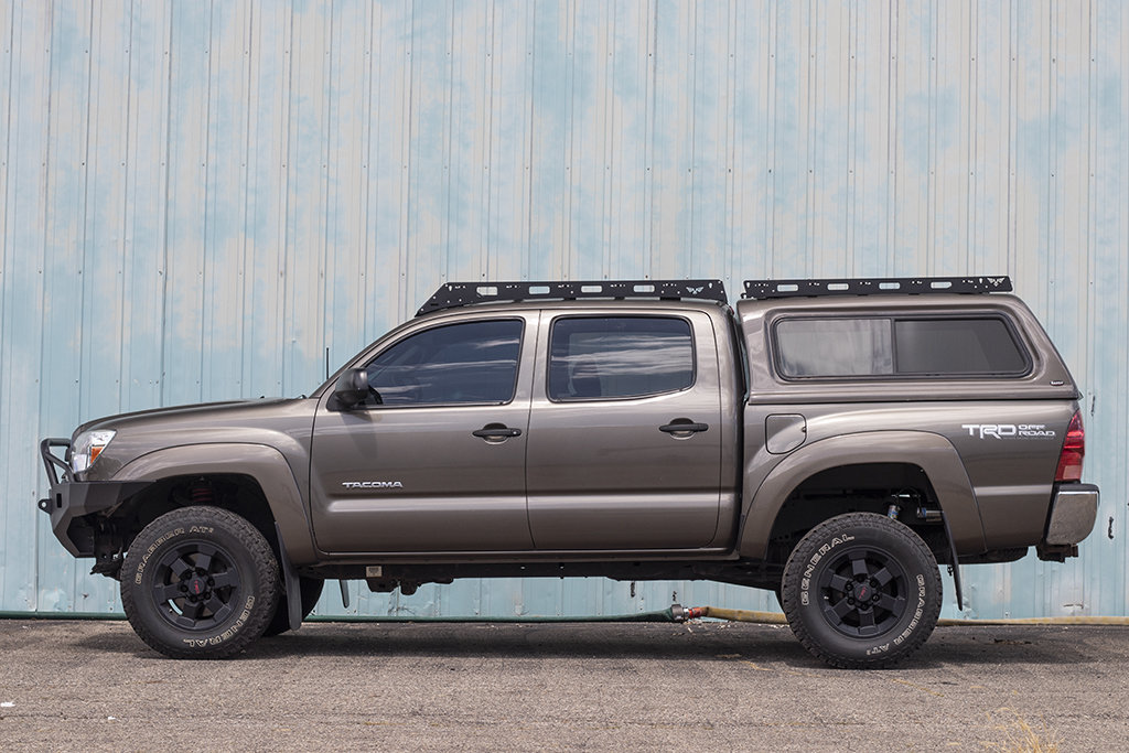

    Option 3 paired with the Bilstein pro kit. Short bed with a topper and Victory 4x4 rack on it.
    I got a solid 6” of lift based on my before/after measurements, but I’m pretty sure my stock suspension was shot, and it has definitely settled a bit over time.

    Ride quality is awesome. Absolute world of a difference over the stock OR suspension. I went with option 3 because even though I don’t have anything permanently attached (other than the cap and rack) I constantly carry a ton of shit in the bed. Camping gear, trailer, drywall, 2x4’s, mini bikes, quads, wood for burning etc etc. I was also planning on a steel bumper for the rear around the same time, I just haven’t done it yet.
    Last big trip was up to Ontonagon in Michigan’s upper peninsula. 12 hour one way trip with 8 guys shit to last a week stuffed into the bed and strapped to every square inch of both Victory racks and the suspension didn’t even flinch. Rode like a Cadillac.

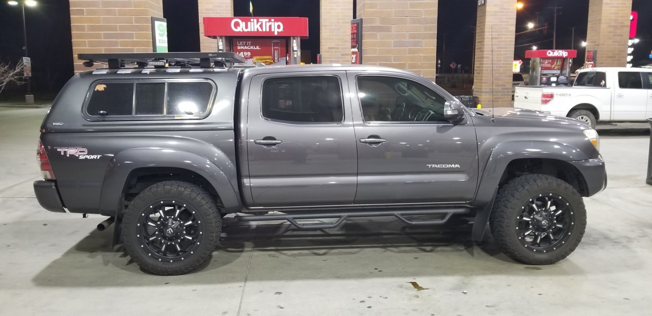

    Looks good. You have some rake, but you also have an aftermarket front bumper as well. What shocks and front springs are you running? I have a similar setup, less front bumper. I am about to install the leaf kit at option 2 with 5100s and 887 springs up front. Picture is "before". I did add a over cab frontrunner rack as well.20201122_205504.jpg

    I have the Bilstein Pro kit on there. I have every intention of adding 1/4” spacers up front to level it out a bit, just one of those things I haven’t gotten around to yet.

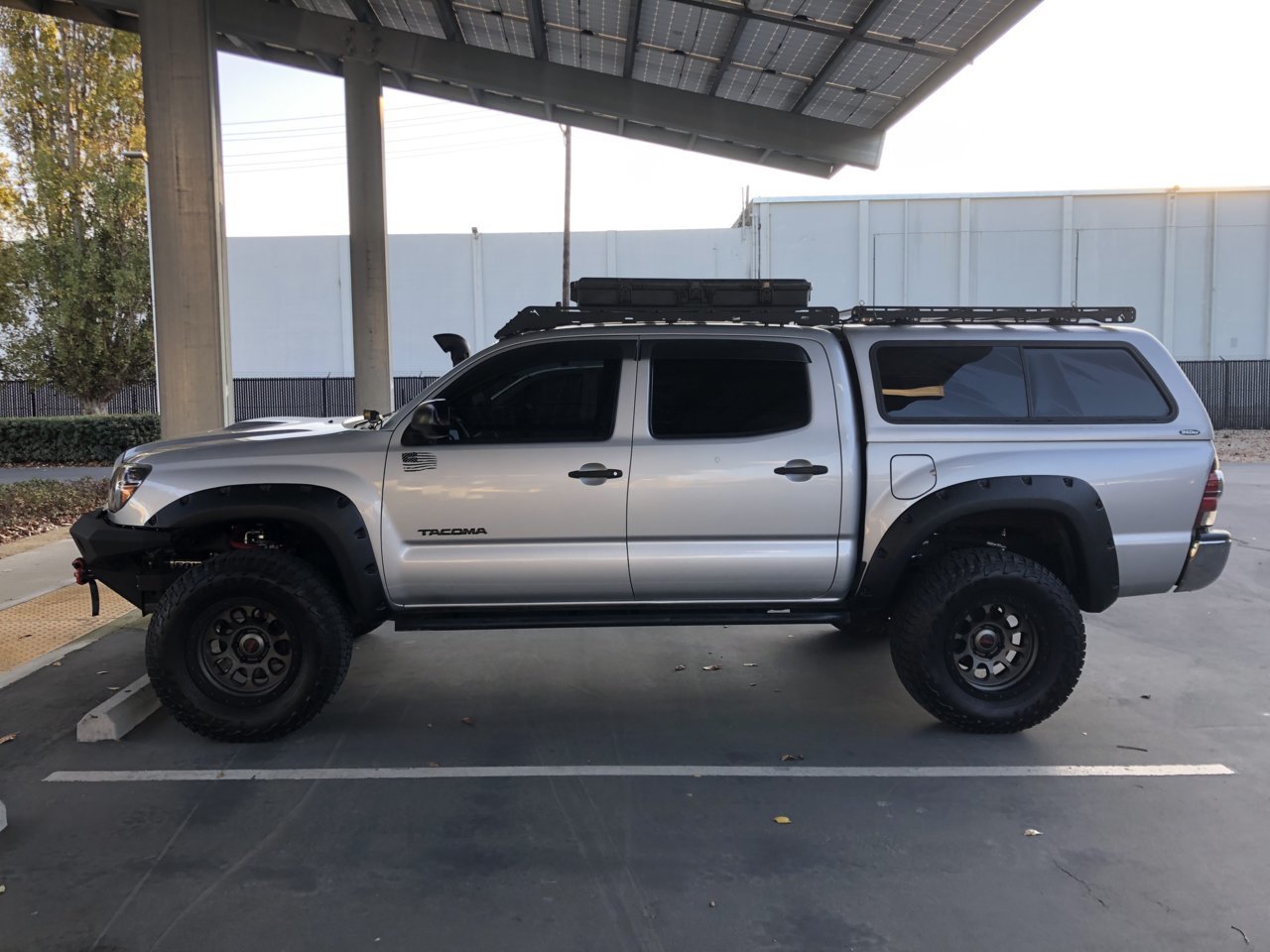

    Option 2. Picture is deceiving because the parking lot is at a slight incline. Need to bring front up a bit.
