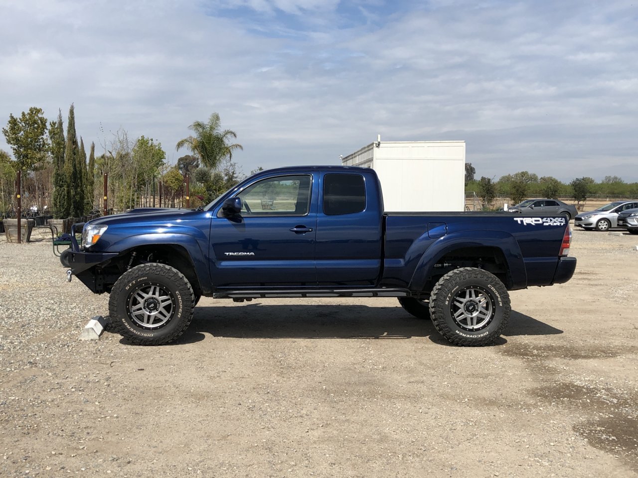

    Im at about 2.5" up front and closer to 3" in the rear with the RXT rear 2.5s. It was really stiff unweighted with option 2 in the beginning but now it rides perfect with about 250 lbs of gear or lumber. I am basically level since I got my sliders and front plate bumper so I would start at atleast option 2 for you. Not sure if you'll get your full 3" after it settles though.
  15. Mar 29, 2021 at 1:47 AM
    #135
    VanDoom
    VanDoom Well-Known Member
    May 11, 2018
    #253217
    144
    Randall
    2006 AC 4x4 Sport
    Icon 2.5s w/resi ET coils, RXT leafs and struts w/resi, TC UCAs, Hole in Wallet
    option 2, unweighted in rear (settled after 3 years) front fenders are cut to appear more even with the rear
    Eastkat808 likes this.
