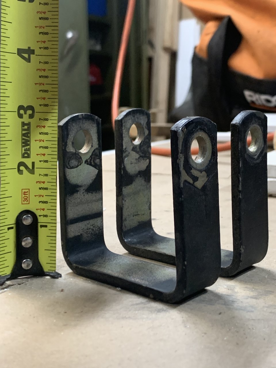

    Man that would be amazing! I appreciate it very much. Name your price I’ll definitely take them. Of course they’ll need to be shipped as I am in CA but no rush whenever you have time.

    Is this what you’re looking for?

    It is! Let me know what you want for them. I sent you a private message as well so I can get your payment info if you are cool with parting with them. Thanks so much!

    The shop that did my install must of threw those out when going from option 1 to 2. Were 1 of those removed per side and what location did they come off of?

    Going from option one to option two doesn’t require any change because you’re just swapping one leaf for another.
    Option three is adding an additional leaf so that’s where the new brackets come into play.

    So it looks like when going to option 3 it's the rear most brackets that get changed out to longer ones correct?

    Yeah, I believe so.
