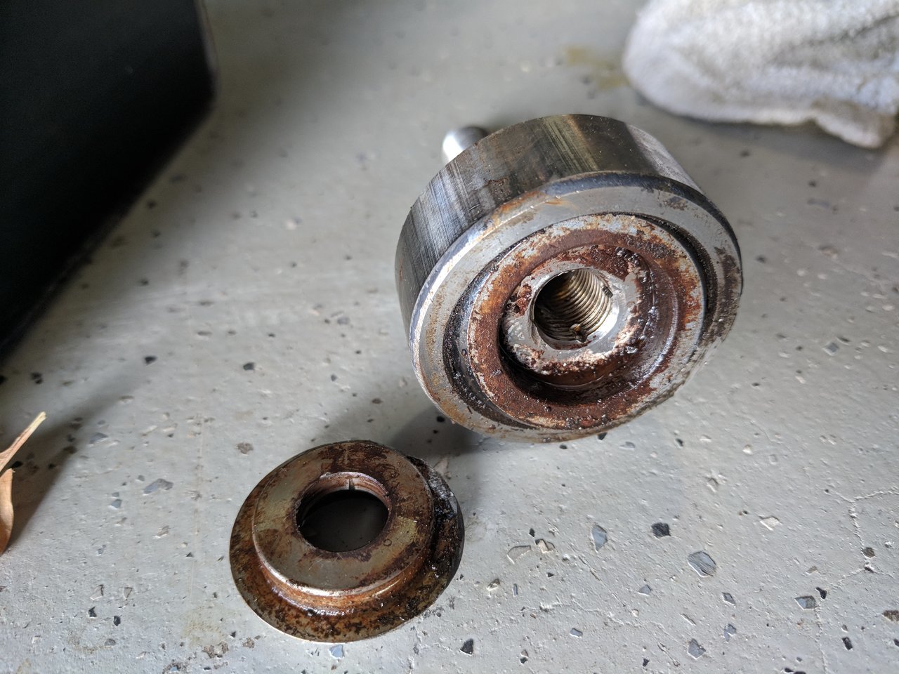

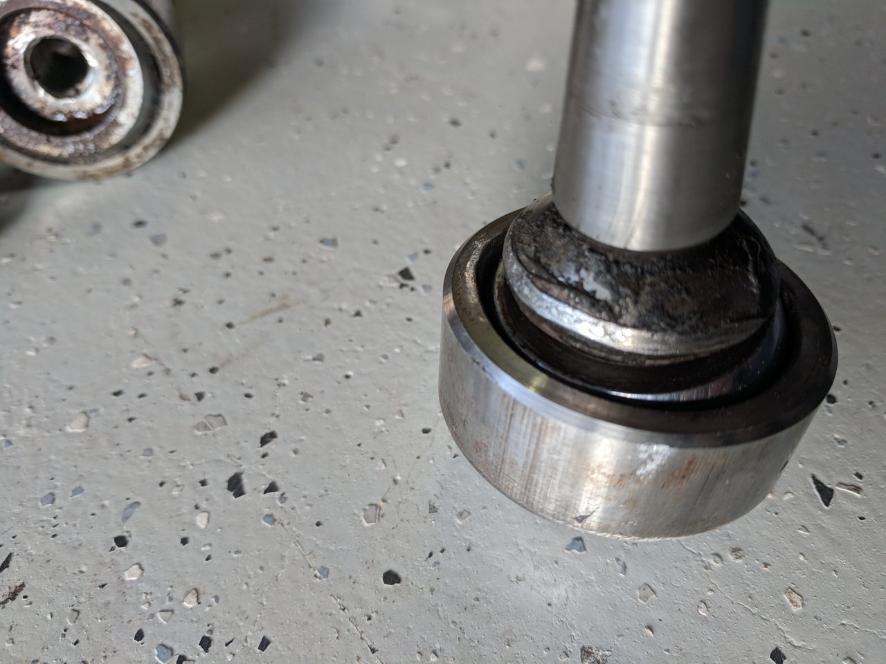

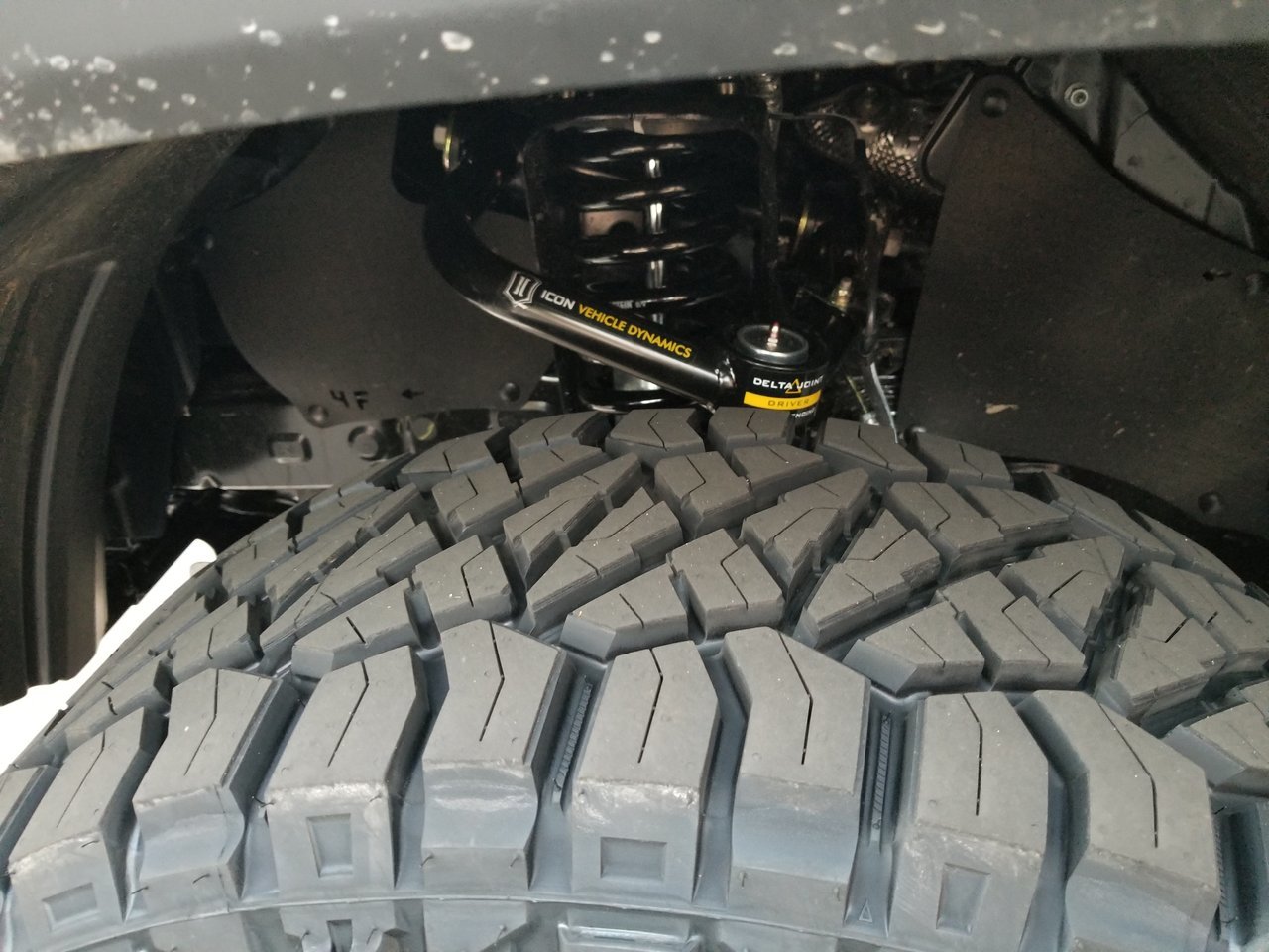

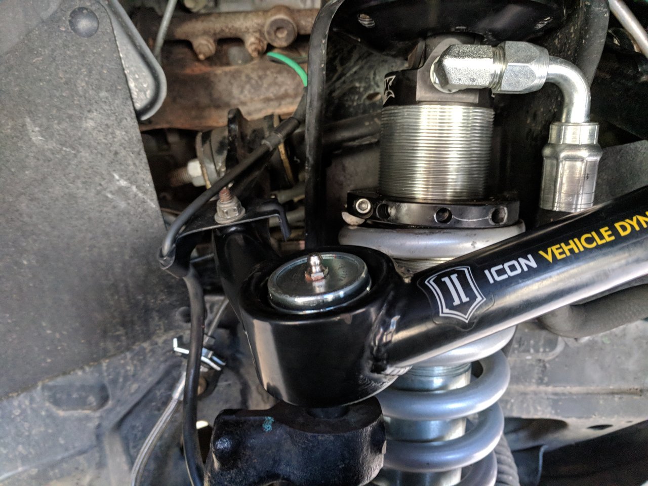

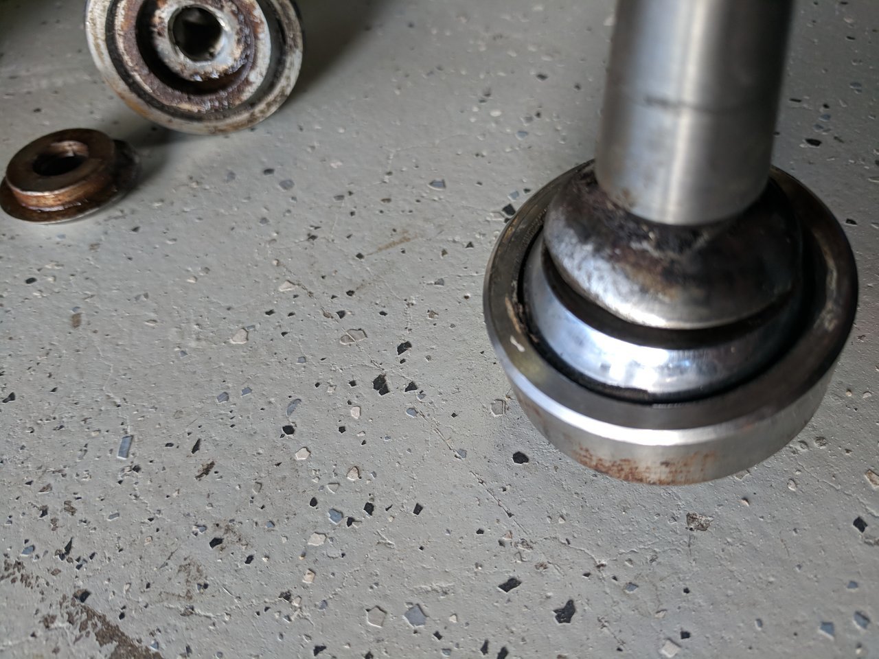

    Well today was the day!!! Glad I got them installed!! Upon further inspection, the spacers on the worn joint were worse than I thought. I dont think the 12pt bolt was ever torqued right, bout this used, and as far as I could tell, the tapered bolt assembly had been thrashing around in there quite a while. The other one that I thought was ok, was full of rust. Both uniballs actually looked ok, and articulated well. Now with the delta joints, tracking at freeway speed feels smoother, steering is effortless, had been binding before, and now I know my ucas wont come apart on me!! Glad I got this done before it was too late!!! Take a look at the pics!! Thanks again @Icon_Adrian!!! Would strongly suggest anyone with the uniballs on their icon UCAs, get the delta joint, you wont regret
