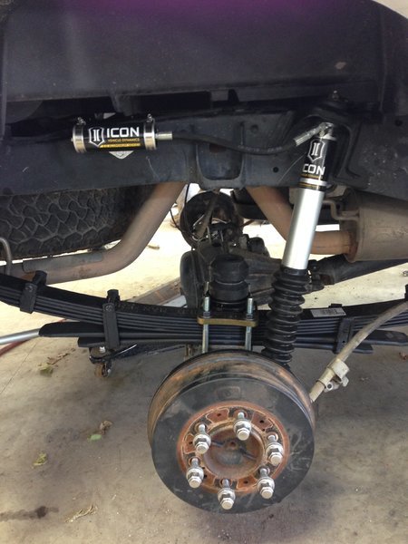

    I've got an Icon stage 4 kit (extended travel remote reservoir front and back) with the tubular Icon UCAs and a Dakar leaf pack in the rear. I would highly advise spending the money for a whole leaf pack and not just an AAL. It rides great and handles the extra weight I have when fully loaded up with gear. Wheelers off road let me keep customize the "kit" with the Dakar very easily.
    Overall I love the suspension and am extremely pleased with the ride on and off road. The adjustability in the front in very easy to do, but once a found a good height I've really left it alone.

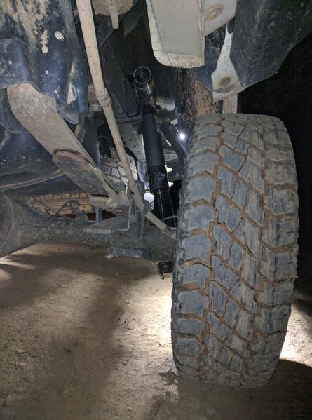

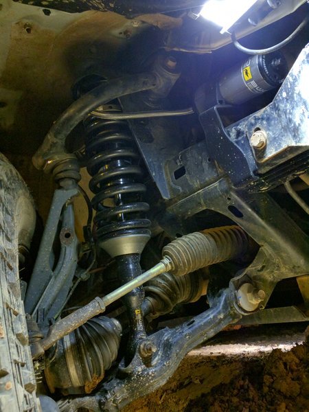

    Comments and questions in red

    Need more pics, I got em.

    Rear lower shock bolts were seized
    Here are my gains, with the same rear leaf pack.
    OME 886s:
    Driver front
    22.5
    Driver rear
    24
    Pass front
    22.5
    Pass rear
    24
    OME BP51s:
    Driver front
    23.25
    Driver rear
    24.5
    Pass front
    23.25
    Pass rear
    24.5
    Thelgord[QUOTED][OP] likes this.
