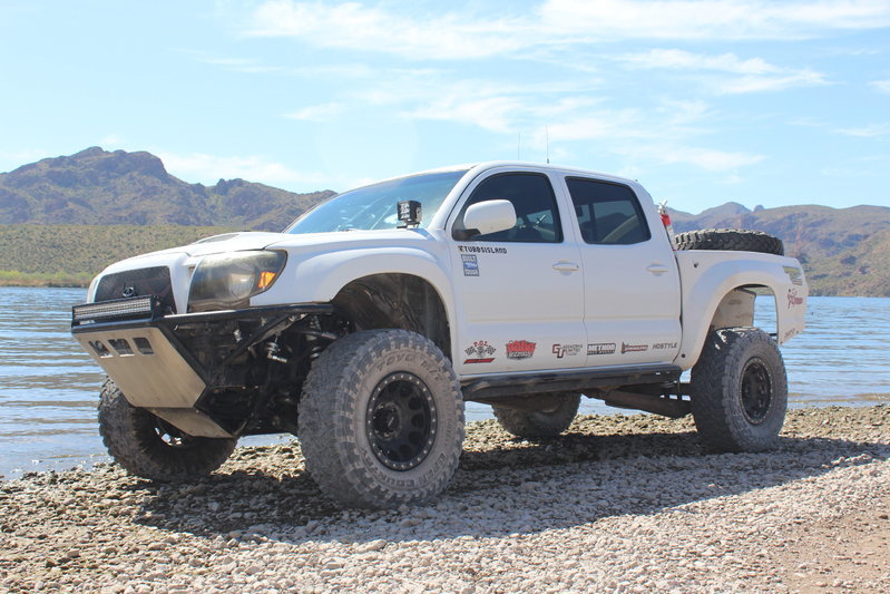

    so not to put you on the spot at all but since you know me and you know how I drive and maintain my vehicles if the issue were 100% a design flaw why have I not had this issue yet with either of my Icon top hats and OEM coil buckets?
    I know, I know. its kind of an open ended question and you cant really give a definitive answer, but with the things I have broken in the ways I have broken them one would reasonably expect that at some point I would have had an issue.

    I don't see any issues with it. Props for ingenuity and proper preventative maintenance :thumbsup: That's the big take away here, if you take care of your equipment it will take care of you.
