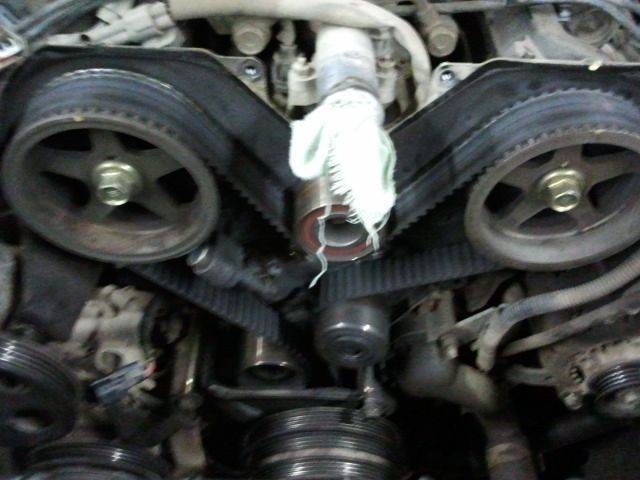

    It will be dripping directly in line with the white rag in this picture, just below the crank shaft.

    Skid is off, only the back piece was wet, the front half was dry. No visible leaks up front. There was a little crystalized coolant above the point where the main line runs from the rad into the block but nothing fresh/wet - sort of tucked behind the oil dipstick.

    :notsure: let it run to get up to temp and nothing exciting happened. i tried to wipe up as much of the leaks as i could so i can see any fresh/new drips and puddles and left the skid off for now.

    Grab the butterfly with your hand and throttle it up a bit and see if the increased pressure causes it to visibly leak. May not work if you can't see the potential leak and reach the butterfly at the same time though... haha

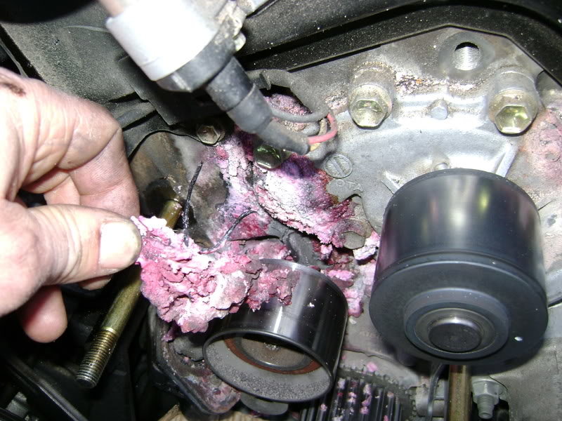

    this is where i found some of the dried gunk (down arrow). above the thermostat (left arrow), hidden behind the dipstick

    Heater hoses?? Lower radiator hose?? Front of water pump??

    Could just be the lower rad hose then.

    Who is beeny?
    Are the backs of the head have any green on them??
    Could be the front of the head right by the hose too :eek: that would suck.

    green? or pink?
    I hope its not HG....I'll settle for a water pump as it is due soon anyways

    pink stuff is formulated for the aluminum rads and shouldn't be mixed with green

    That lower arrow points to the thermostat, so the thermostat gasket is probly blown.
    There is NO reason your HG would be leaking...
