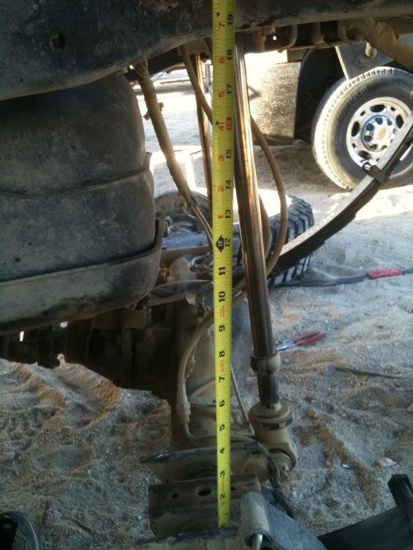

    I see. I was out testing something for another thread earlier and I can hit speeds bumps around here hard and not bottom out my front end or the rear. As for whoops and jumping though... They can be a bit rough...
    This is me going up hill and I hit a small whoop going 40+mph, front absorbed it just fine but the rear bucked up hard.
    Are you still using the factory shackle hangers in the back or did you do a shackle flip? I was thinking about getting the ATO shackle flip and a longer shackle but I can already overextend my rear shocks and I don't want to buy any shocks until I have new leafs and shock hoops.

    Won't be able to not get new shocks without the shackle flip. Adds a ton of droop.

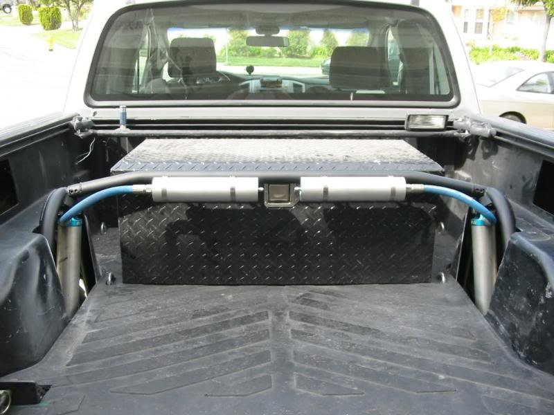

    This is the defined kit. With my body lift I could possibly run the hoops and just mount the crossbar lower maybe.

    Nah the crossmember is up there for a reason haha gonna have to be basically that. If it's not mounted at the top then too much flew is induced I'd think.

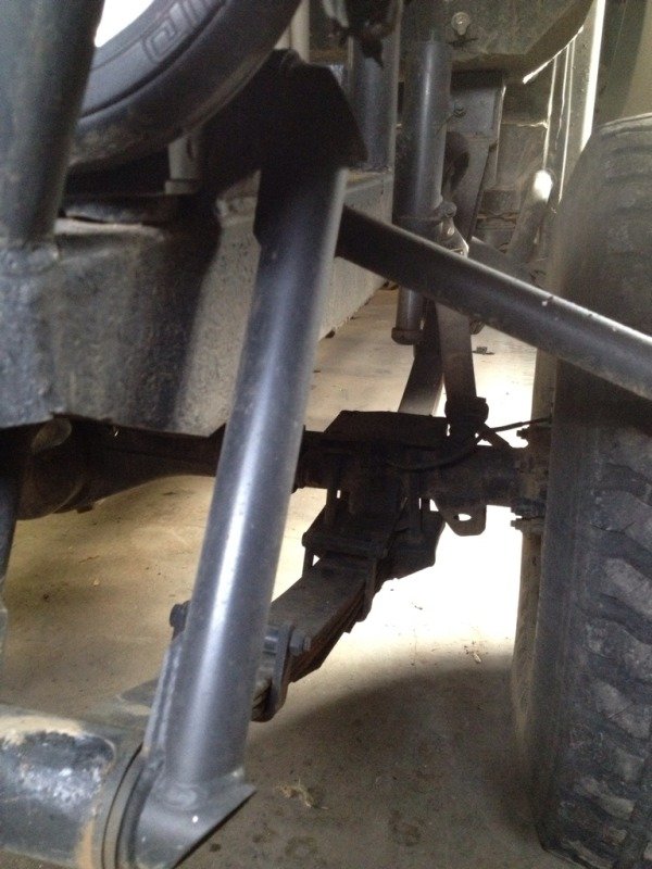

    I'm using TC 12" shackles.

    I was thinking maybe put two bars across it. I doubt it would be much lower. haha Not even sure I can clear the toolbox with the hoops anyway...

    Whoa! Your shackle is mounted on top of the frame.

    that's how it's supposed to be
    otherwise....you end up with really fucked up geometry

    Lol yea..what all LT rigs are. You got a lot of reading to d Brady haha
