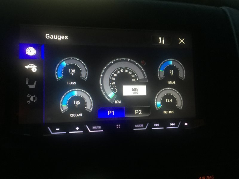

    Here are two screenshots of an idatalink Maestro RR installed. Programmable steering wheel controls with on screen display of tire pressure, MPH, A/F, RPM, etc. Used in conjunction with a Pioneer AVIC-8200NEX. Toggles via the mode button on the steering wheel.

    Does it support the Transmission Temp as well?

    Yes it does.

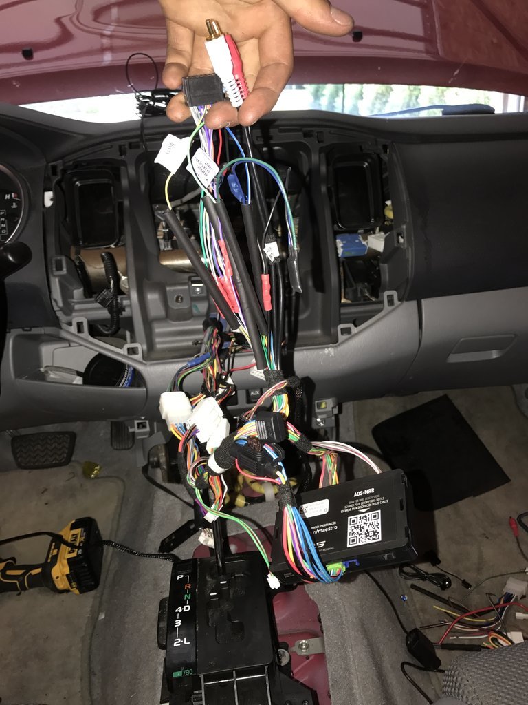

    Going on my 6th hour looking at all these wires trying to figure out what goes where, I would not recommend this unit to anybody just due to the huge headache of install. I have flashed the Rr, I found the wiring diagram and believe it is all correct, hooked everything together and turned the key hoping to not mess with it anymore and it didn't pop up on the screen. Not sure what I'm doing wrong if anyone could help you would be a life safer! I don't get a green light on the Rr or anything If anyone has a picture could you post a picture of your wiring harnesses if it is clear or explain what I'm doing wrong if you know

    Hmm, well I guess that won't work then. You may have to submit pics in order to see what exactly is going on. You ordered the TO-1 harness with the unit?

    Yes I do have the TO1 but I do have some wires left over but I'm following the wiring diagram

    Rats nest of wires lol I can take more detailed ones if you can help!
