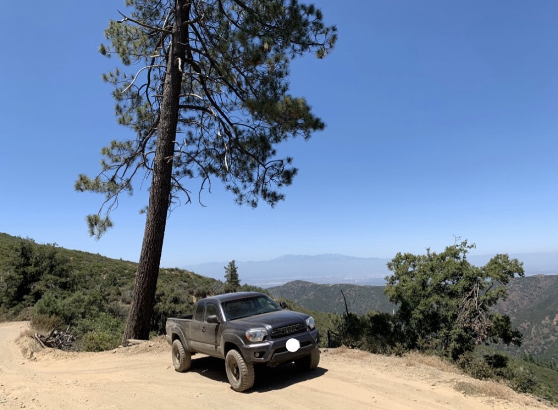

    I've had very good luck w/ BF T/A KO2's- very good grip and they wear much better than you'd think for such an aggressive tread- they are offered in both E and C ratings
    I go just one size up on my very stock 12 Tacoma, gives me just a little more clearance and no worries whatsoever on rubbing- 265/70/17's

    Yeah I like the BFGs a lot, and have heard good things about them. What brands and models are most comparable to the KO2s?
    Also what bull bar is that you have on your build @big sky ?

    it's from avidoffroad- very happy with the quality :)

    I will have to check it out, it looks nice!
