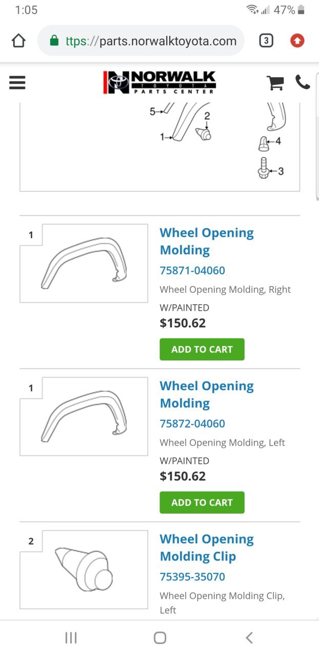

  5. Jan 15, 2020 at 1:10 AM
    Foster1
    Foster1 Well-Known Member
    Oct 1, 2019
    #306837
    668
    California
    2023 SR V6 4x4
    These are it I think. Expensive af for just plastic.
    Other options would be to try and switch with someone with an off road on the for sale section, or buying off brand ones.
    As for plastidip, it only looks bad if you do a bad job. Have to keep it shined up or else they start to look faded. I used to use tire shine to keep the plastidip looking new lol
