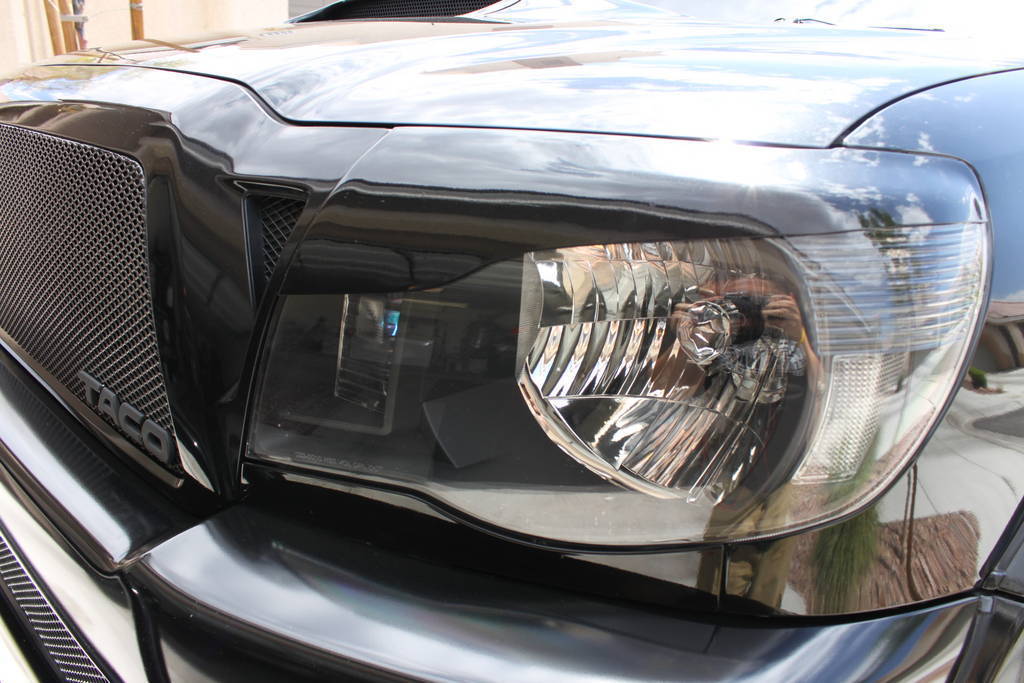

    When yu get them go buy silicone from home depot the clear industrial strength run a beed arount the hole lens were it meets the body of the light then run your finger around pushing it in the cracks let dry over night thn run a nice beed again around to make sure 100% seal! Your will be good!:thumbsup:
    This is mine after a year and a half!

    That looks awesome, I cant wait to get my grill craft and do these headlights. Did you mount lights behind your grillcraft? if no, why not, if yes, which ones?
