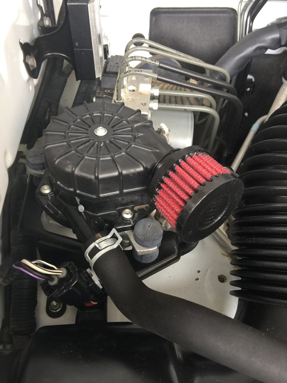

    Can anyone tell me what this is. I need to replace the filter.

    Air pump for the emissions, thats an aftermarket filter, its not an issue on your motor, there's usually just a plastic cap that clips on.
    What year/motor do you have? Is it relocated?

    The filter isn’t even dirty.
    That’s the secondary air pump with an aftermarket filter. It’s was a known issue that the stock filter would come apart and do damage
    looks like someone fixed it for you

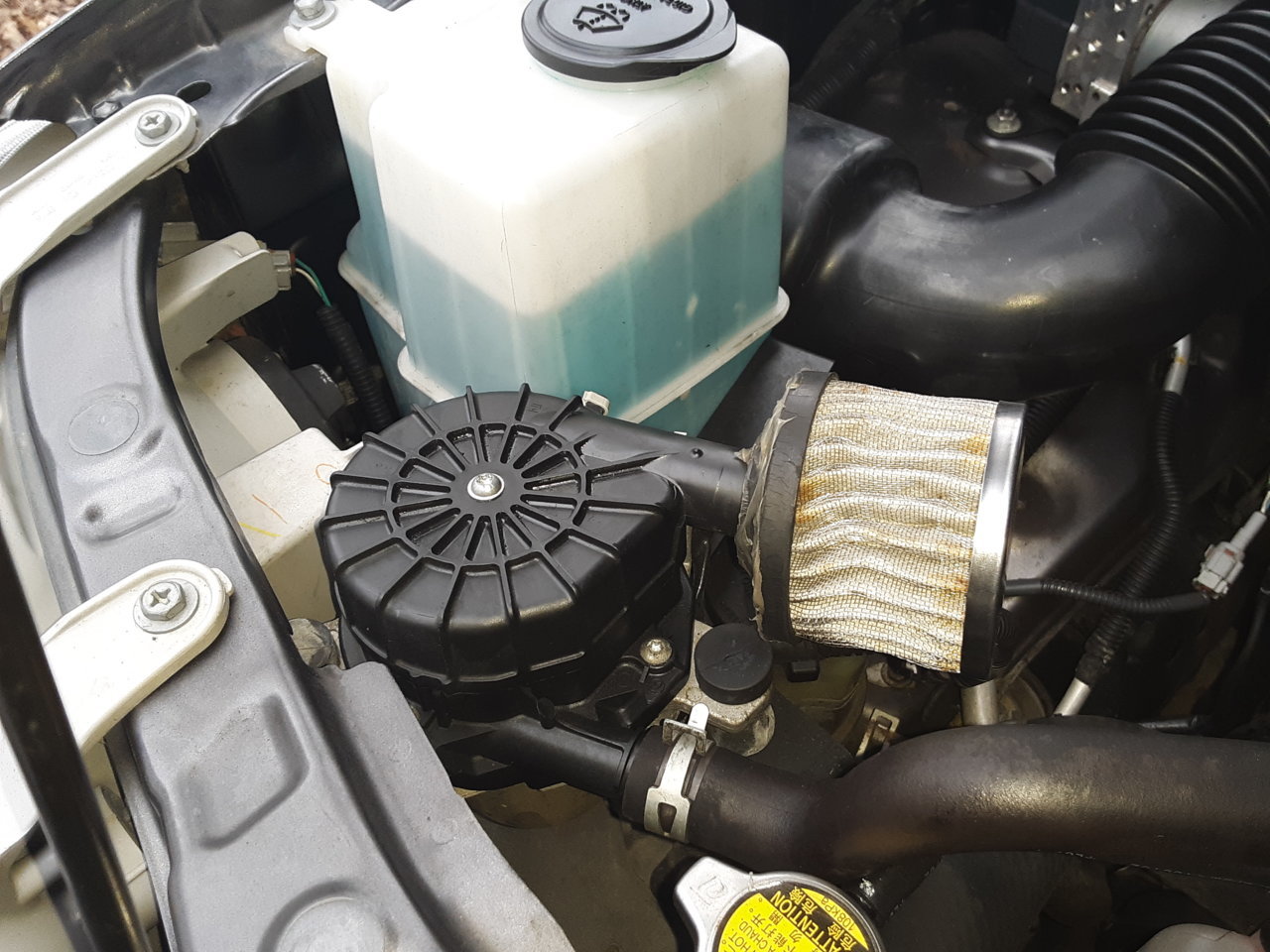

    Exactly what @nd4spdbh said, and the result should look like this.

    Thank you. Just ordered replacement from Amazon. It's a 2015 4.0 L V6 trd pro

    I believe previous owner moved it. They did some mods to this vehicle. its mounted in the wrong place. If I move it back I'll have to get the oem mounts for it. Any idea where I can find those oem mounts

    PO probably had an aftermarket CAI. I wouldnt worry about moving it back to the stock location. I would like stated, open it up, make sure the foam is removed, pop off the siliconed on breather put a uni on and while you are there check and make sure that the stock intake is all secured properly with a proper engine air filter.

    Yes. Ordered the parts and checked inside no foam, and clean.

    There is a TSB for the secondary Air Pump. With non OEM parts on it if it fails your looking at a $2000.00 +/- repair.
    With OEM your bill will be covered by Toyota 100%
    disclaimer;
    I don’t know what model years are covered by the TSB but my 2012 was covered.
