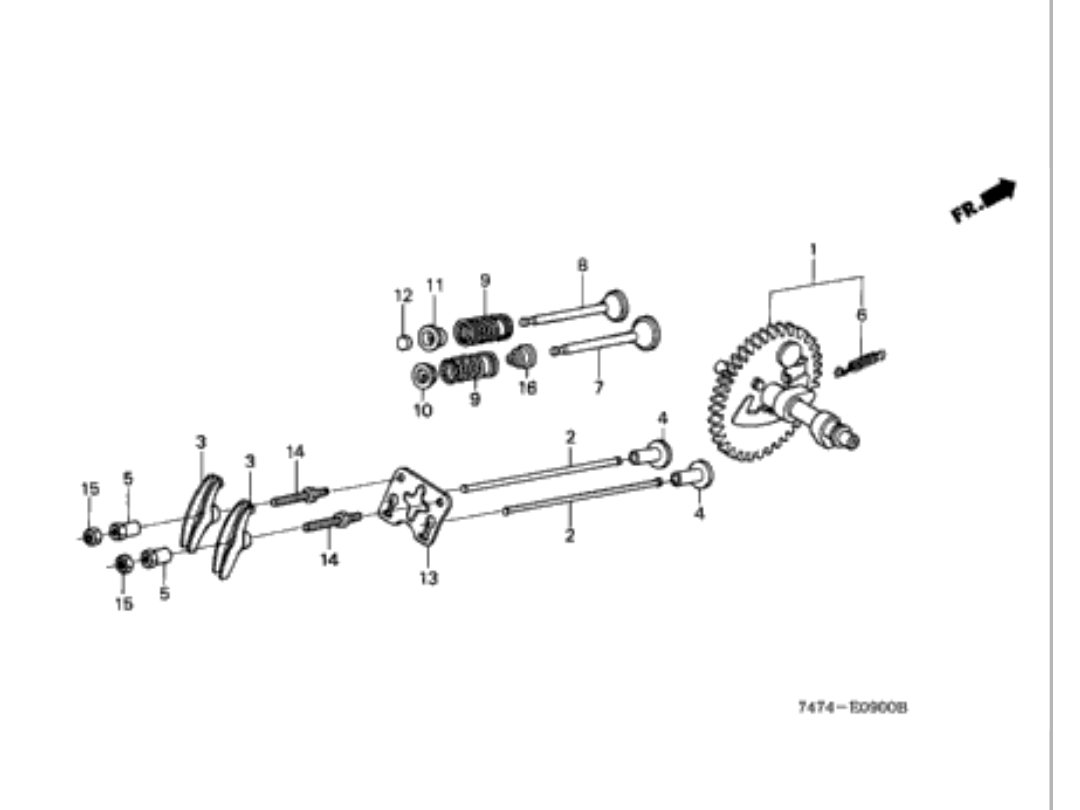

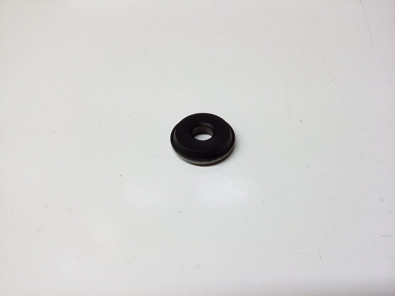

    Found this extra part (it's about 1/4" across) on the floor as I'm in the midst of rethreading a spark plug hole on a Honda hs621 snow blower. I'm guessing it's maybe from the valve area, but could be from anywhere!
    It's my first time doing small engine repair.
    I had the head off because when I got this machine the plug hole was so badly stripped I couldn't line up the rethreading tool properly so decided to go from the inside out. So that's done. Now about to put it all back together and I see this part.
    The part looks like it might have had some oil on the inside, and dry on the outside.
    I sort of did the minimum removal of stuff possible just to free up the head so I could work at the hole from the inside.
    I had the valve cover off. Left most of the throttle stuff attached to the head.
    More description: smooth on the outside bottom. Inside bottom has a little cup or dimple.

    Valve stem seal?

    This exploded view from Honda doesn't list a part or # for reference 16
    davidstacoma likes this.

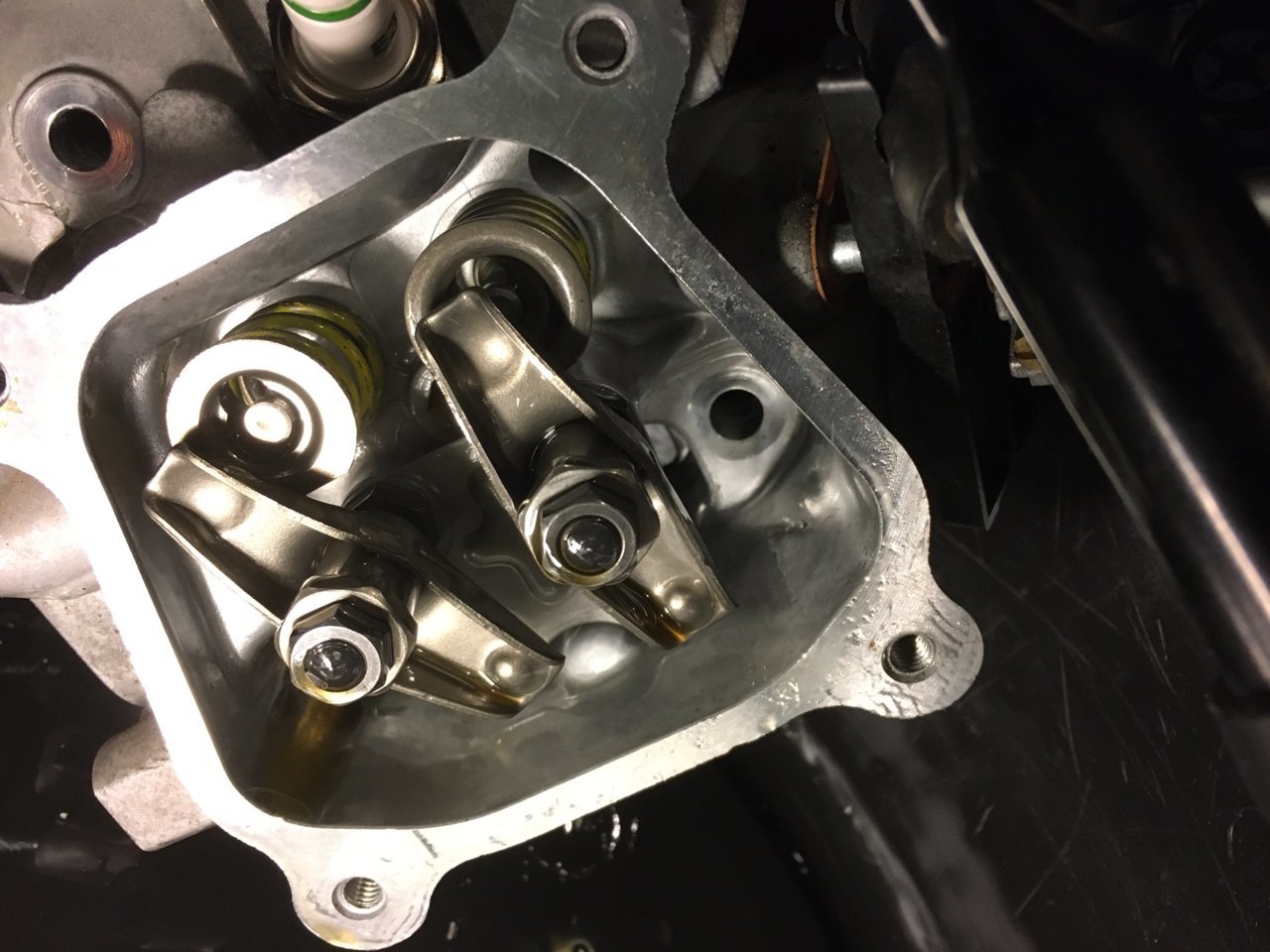

    The valves are still flush against the head. Doesn't #16 need to be hollow? Here's a pic of mine, with the rocker arm swung over a bit since the long push rods are out.valves.jpg

    Actually it would have to have a hole straight through for it to be a stem seal

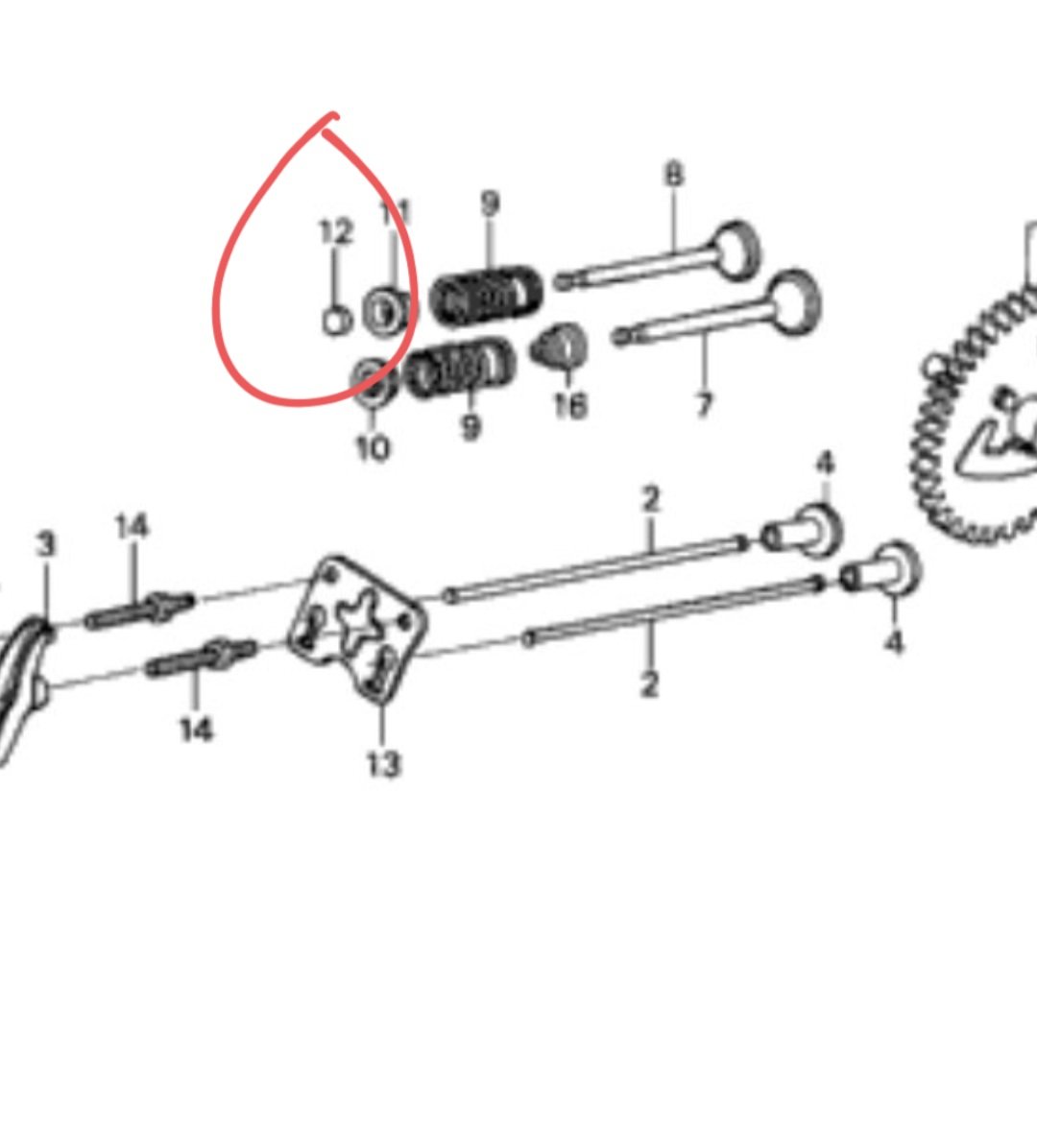

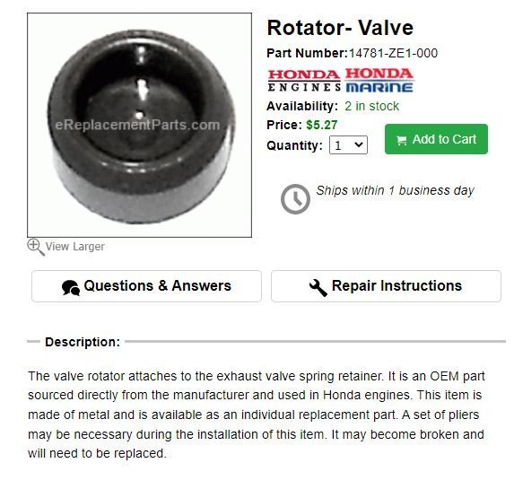

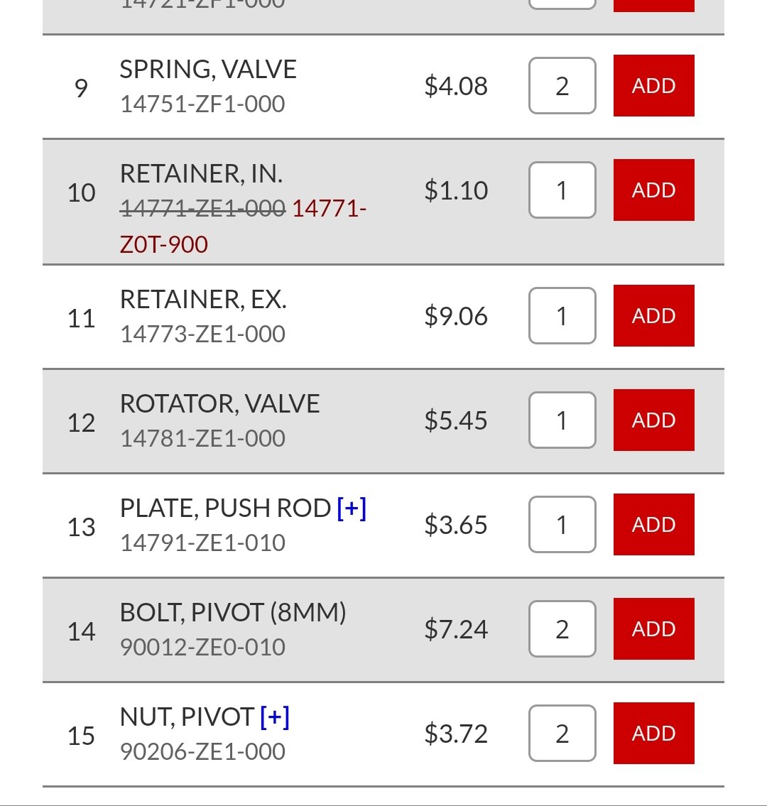

    UPDATE!!!!! GOT IT!!! Thank you all for ideas.
    It is a rotator valve (also seen it called elsewhere a "rotator valve protection cap"), according to this.
    So that would be #12 in the schematic posted by mtip.
    The top left of my pic (where the rocker arm is off)

    Id say left as orientated by the pic and diagramScreenshot_20211212-194324_DuckDuckGo.jpg
